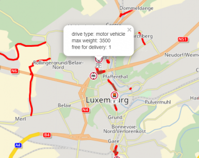

- Screenshot from the showcases XServer Internet. Displays some TruckAttributes in Luxemburg, e.g. weight restriction, height restriction, hazardous goods
