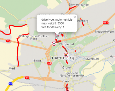

The counterpart of the vehicles property is a truck attribute on a street which is used to determine whether the vehicle is allowed to drive on that road: If the maximum weight attribute of the road is lower than the value of the vehicle it is not allowed to drive on that road.
To make this work you need to
- specify the attributes of the vehicle via request profile or stored profile
- and activate the PTV _TruckAttributes feature layer
