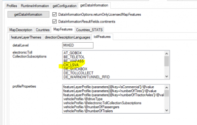

xRuntime2.getDataInformation response
You can check the coverage within xRoute 2 in this toll showcase.
I also created some sample requests with routes (40t truck) from basel to Zürich.
Check the screenshots below.
