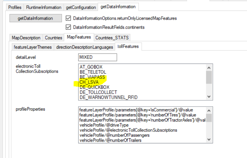

yes our xRoute Servers do return swiss toll based on the LSVA.
xRuntime2.getDataInformation response

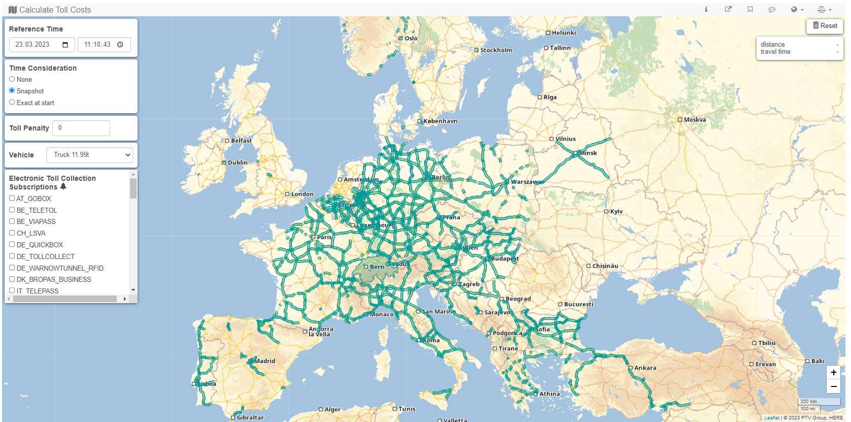

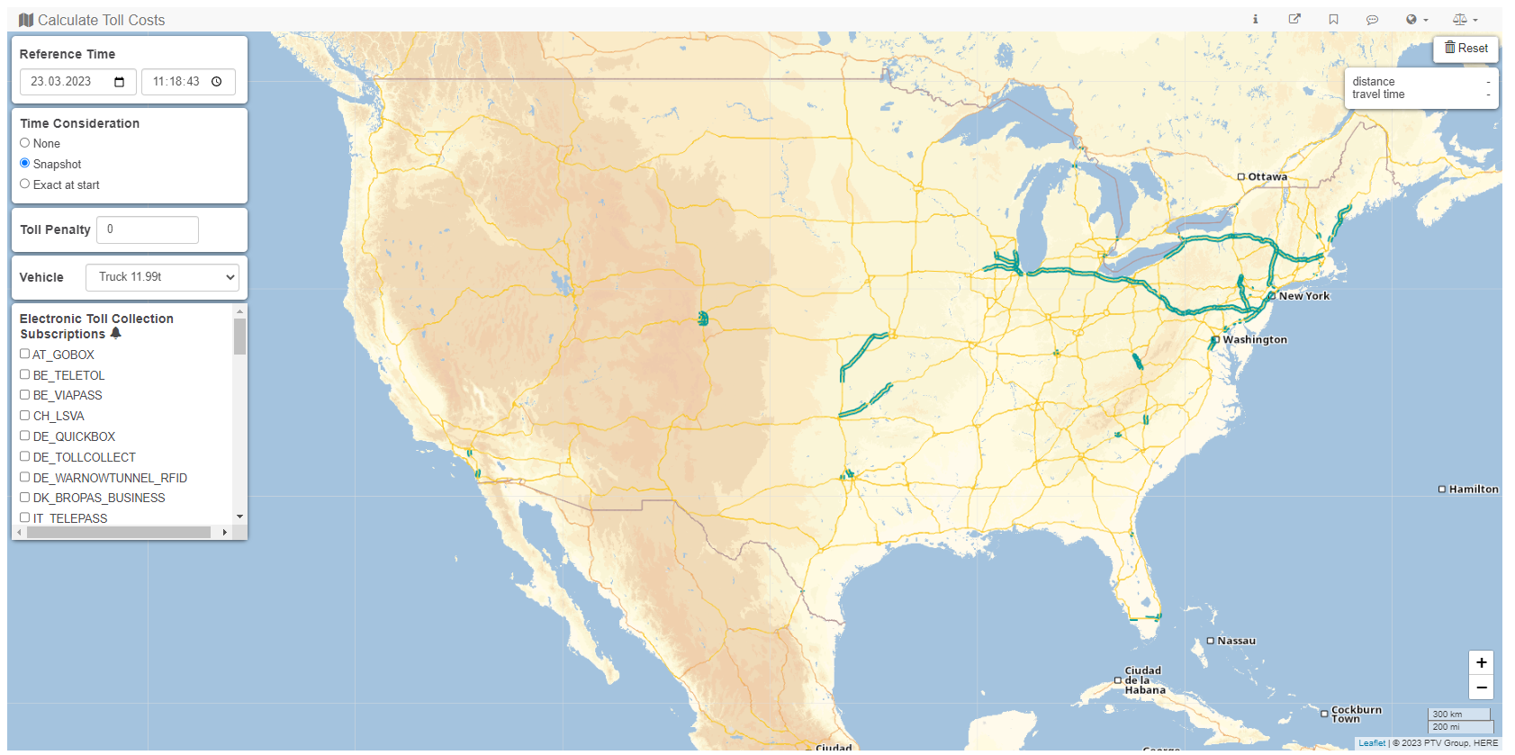

You can check the coverage within xRoute 2 in this toll showcase.

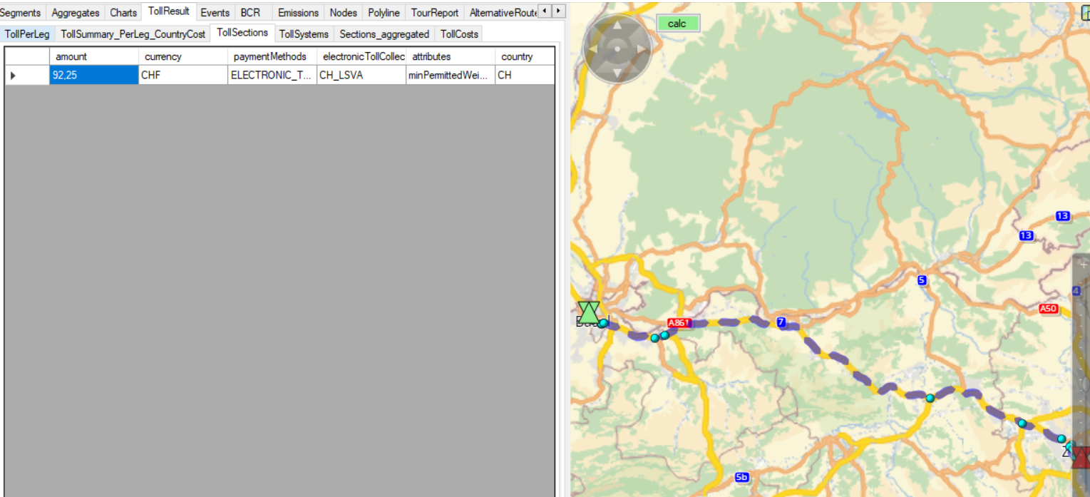

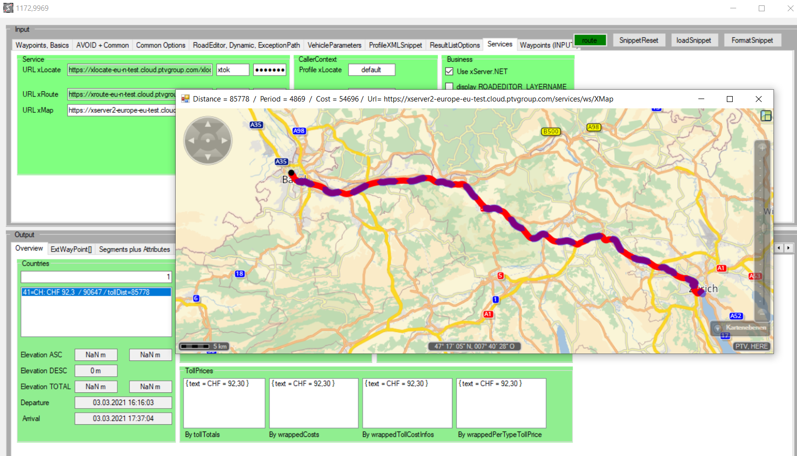

I also created some sample requests with routes (40t truck) from basel to Zürich.
Check the screenshots below.
United States coverage as of 2023.1H (march 2023)
European coverage as of 2023.1H (march 2023)
xRoute 2 - here we also mention the name LSVA in the result.
xRoute1
xRoute1
