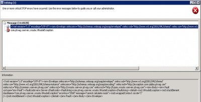

we have a customer running an older xServer version (xRoute: 1.8.2.2) and we recently updated the map from 2018H to 2020H (Europe City Map Premium 2020.1H).
After the update we get an issue with an habour address in FIN, Oulu: Poikkimaantie 12, 90400 Oulu. After the map update we get the following error:
1. We don't know why this street is blocked now. Can you help us with it?
2. How could we solve such issue?
BR Thomas
Road cannot be accessed anymore

Re: Road cannot be accessed anymore
I was actually not aware of it. I need to now check this and see if the update of the profiles was done. If not, I will update them and test again.
Hi Thomas,
wow, 1.8 is quite old. I'll get in touch with you 1:1 to check next steps.
At least an update of the engine is really recommended, too!
Please be aware that we can't investigate in such old engines. If such an error still occurs with the latest engine we can have a look at it.
