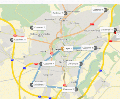

Use the changeToursRequest with a MoveOrdersAction or MoveStopsAction. To ensure the proper position within a target tour use InsertionAtBestPosition.
Click Image to see the animation: <br />Showcase example: add single, unscheduled order to an existing tour at the best position
  • You have to process this transaction for each potential target tour so it is a bit more complicated but due to the limitation to InsertionAtBestPosition it is still very fast.
  • On the other hand you may try to use parallel requests to speed up the process.
  • If you want to evaluate even more than one potential position in a target tour you can use the xtour.InsertionAfterSpecifiedPosition or xtour.InsertionBeforeSpecifiedPosition and iterate over each existing position in the target tour
  • Refer to a storedRequestId, so you won't have to transfer the whole scenario again and again.
Play with the showcase to get an understanding of this mechanism.
