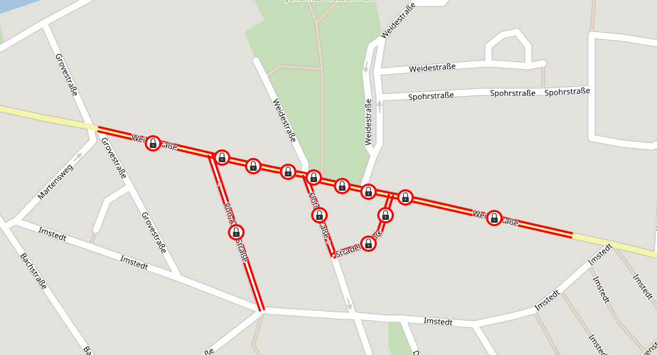

I am currently working on an app that allows users to maintain short time road restrictions by using XDatas custom feature layers (for example when there is a construction site).
To give a quick overview of how we are planning to use it, you can click this .gif:
You can see the result here:
I wanted to give some constructive feedback on the functionality of XData, and would be happy to hear your thoughts.

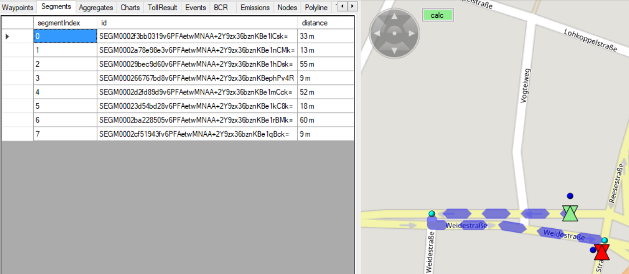

1.) IMO the best way to select the affected segments in our use case is a combination of XRoute>calculateRoute and getSegmentsByIntersectingPolyline. This requires some additional computing since getSegmentsByIntersectingPolyline also returns segments that are adjacent to the original route. Being able to easily retrieve all segmentIDs of a given route would be very nice.
2.) Apart from using timeDomains, the maintenance of singular Features is not possible by default. It is only possible to delete a whole featureLayer, not single Features. For our use case, we need to maintain a database with all features. Whenever an existing one is deleted/edited, we collect the features from the database and overwrite the existing FeatureLayer.
3.) Given a specific SegmentID, it would be nice if we were able to request information to this segment, for example, it's Polyline.

1. how to gather the segment IDs of specific route? Well, for this you'd simply need to calculate the route and request the segment info from xRoute. At least I hope this does what you asked for. 2. recreation of complete CFL required each time a single feature changes: you are right. That's a weakness of the current design. The approach forces each player who wants to maintain CFL for an individual database where he stores at least SegmentIDs and "features of the segments" and then to dump the data into a CFL whenever a single value changed. Not nice. Unfortunately required at the moment. (You could also store the selection criteria to ensure that the dump process also works fine after a map update.)
