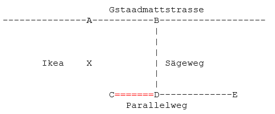

The situation matches the conditions of the blog post. What is confusing is that you parametrize
  • isDelivery=true
  • deliveryVehicles SegmentMalus=2501 (same applies for Emergency)
This doesn’t make sense because you allow the engine to use segments with “freeForDeliverys” flag but then you block them immediately through the malus of 2501.
  • The segment C-D is generally blocked for cars and trucks but has the attributes “free for delivery” and “free for emergency”
  • All other roads in this area are generally allowed for cars and trucks
  • At D we have banned turns which have only the attribute “free for emergency”
    • coming from B it is forbidden to continue to C
    • coming from E it is forbidden to continue to C
  • • Linking the destination waypoint X at the Ikea depot we have a different behavior depending on the parameters isDelivery and isEmergency (and DeliveryVehicles / segmentMalus)
    • isEmergency=false
      • isDelivery=true (and DeliveryVehicles/segmentMalus < 2501)
        • X is linked at C because C-D is free for delivery
        • This is problematic because we cannot reach C because of the banned turns. Normally such banned turns should have the attribute “freeForAuthorized”
        • The result is “route not found”
        • The only way to ignore the banned turns is by setting also isEmergency=true (and EmergencyVehicles/segmentMalus < 2501)
      • isDelivery=false (or isDelivery=true and DeliveryVehicles/segmentMalus = 2501)
        • X is linked at the second nearest road at A because C-D is not allowed for non-delivery vehicles
        • The routing is successful and reaches X through A
    • isEmergency=true (and EmergencyVehicles/segmentMalus < 2501) and isDelivery=true (and DeliveryVehicles / segmentMalus < 2501)
      • X is linked at C
      • The routing is successful because the normally banned turn E->D->C is now allowed because of isEmergency=true
        • X is now reached through C
Here are the two approaches that enable a successful routing:
  • Approach #1 : Set isEmergency=true and reduce the distance to X. In this case it may look like it is wrong. If you crosscheck this via Google Maps it looks “wrong”
  • Approach #2 : set both isDelivery and isEmergency to FALSE and keep the malus values lower 2501. This will create a route via the ordinary road which is a bit further away from X. On a generic level this will prevent you from entering zones which are restricted to “freeForDelivery”.
I hope this answers the question.
Bernd[..]

Thank you for the detailed explanation Bernd!
We will go with isDelivery=false, isEmergency=false.
First tests show it will work in our scenarios.
