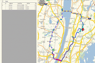

Sample route from Englewood (NJ) to Scarsdale (NY) with a semitrailer 5 axles: based on the tarifs I've choosen the detour is cheaper because it avoids the expensive toll on the southern brige alternative.
