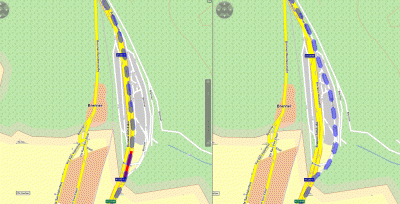

Case 1 - pic1
- from: Bolzano
- to: Innbruck
- without turning on the allowance of the violations the algorithm won't let us go trough the Brenner-pass
Case 2 - pic1
- from: Bolzano
- to: Innbruck
- if we allow the violations, then it let us go trough the Brenner-pass, but says that we have a violated segment: AT 6156 Gries am Brenner Brenner-Autobahn, 7,5T weight violation

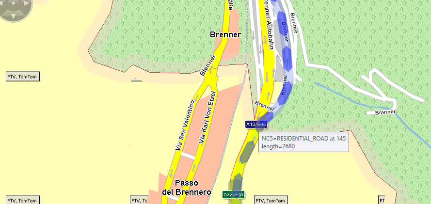

Case 3 - pic2
- from: Vipiteno
- to: Innbruck
- however, if we route from Vipiteno, than the route goes through the Brenner-pass, with the same profile, without any violations
Pic1:
https://innomanagement.hu/ptv/2020-09-30/pic1.png
Pic2:
https://innomanagement.hu/ptv/2020-09-30/pic2.png

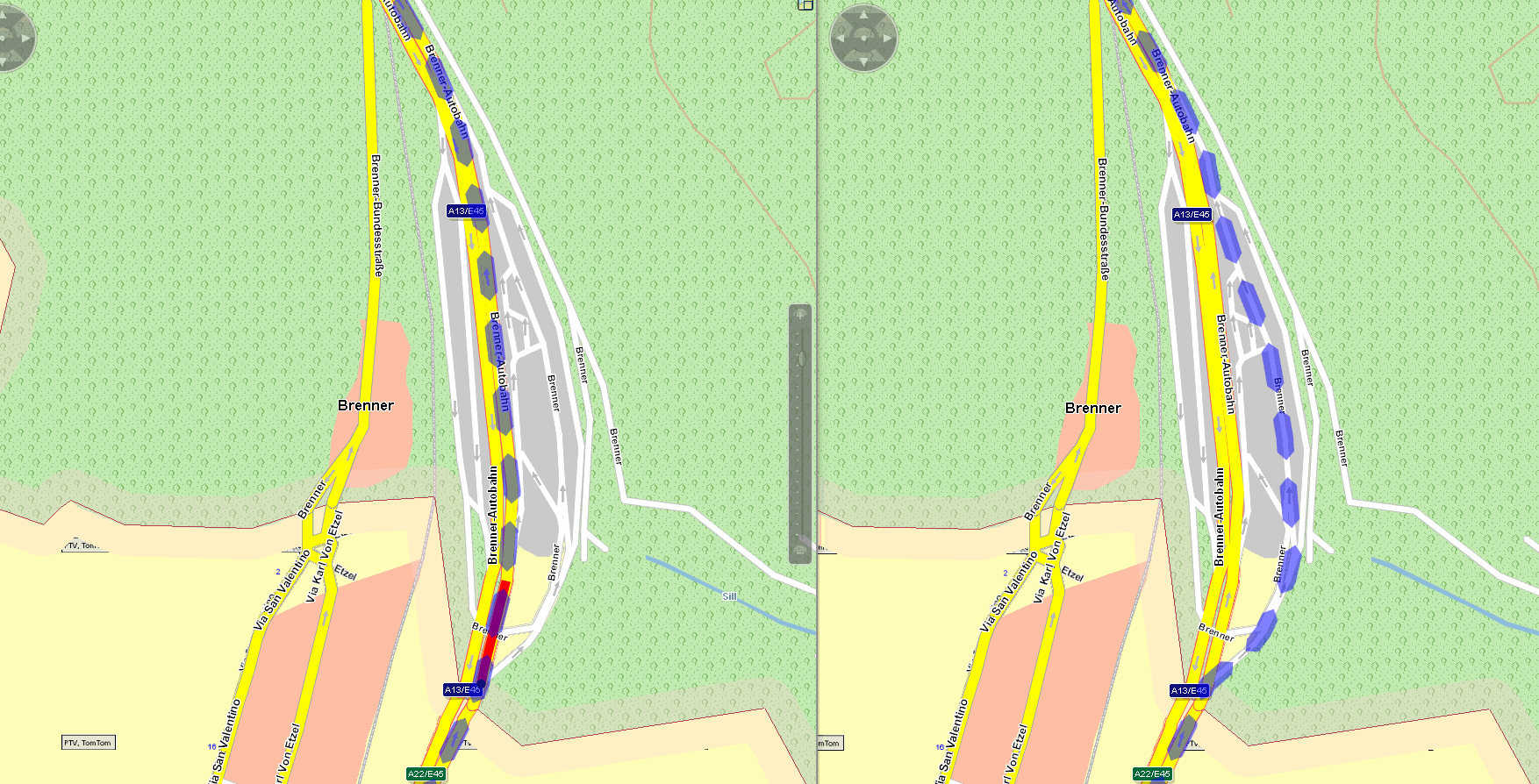

I tried to reproduce the requests in the cloud:
https://xroute-eu-n-test.cloud.ptvgroup ... /ws/XRoute
Looks like the server performs a very little detour with the third request Does this explain the behaviour? The sub routes are not really equal
PS: images are animated, click on them)

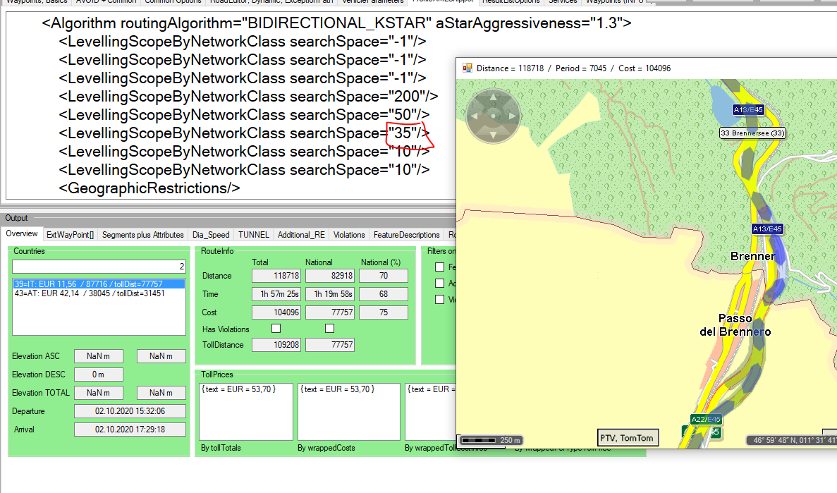

Now that was a big challenge.... First I didn't get what exactly you wanted to have but I think I get the point now...
As I mentioned in the previous post under some circumstnces the router takes a local detour to avoid a violation. The detour requires the engine to use a segment of network class NC_5. As this is a minor category the scope (levelling) is a relevant factor here:
The regular search space considers NC_5 with a scope of "20" which means "do not consider NC_5 segments if they are further away from any waypoint that "20" (kilometers).
So when at least one waypoyint is close enough (scenario #3) the detour is "possible" because the NC_5 segment is "known".
If you start your route in Bolzano (too far away from the relevant NC_5 segment) with the scope of "20" (or even "30") the segment is "invisible" and the engine neeeds to perform the detour to avoid the conflict/violation. By setting the Scope to about "35" the scope is large enough. Ok with that?
