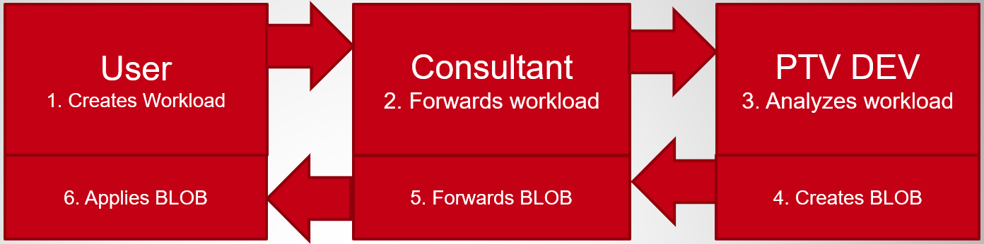

Finally here’s the workflow diagram – If you want to apply this approach in a project I recommend to get in touch with PTV’s technical consulting. We will evaluate the user story and if it matches the processe’s skills we will provide an offer for this from a professional services perspective. In any case we should ensure whether It is promising in the current context or not and then answer the client.
process workflow... provide small samples and requirement to consulting and we will handle it internally with DEV.
