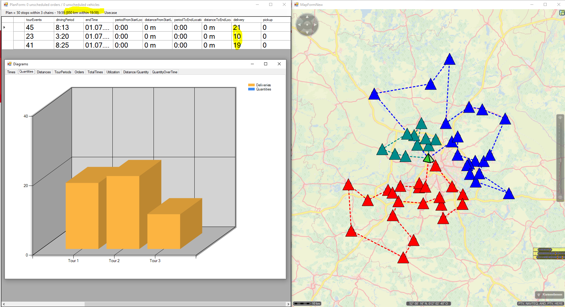

Standard planning with sufficient capacities. The utilization of the vehicles differs a lot

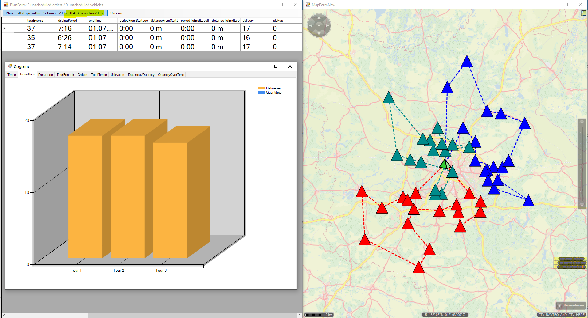

I did set the quantity per vehicle to 17 but the price we pay is the KPI: total distance increases from 950km up to 1040km.
