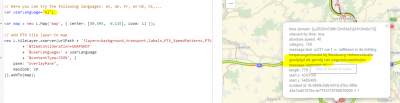

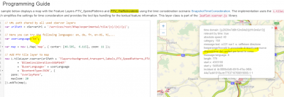

I have some good news and some bad ones:
Good news: we have texts in other languages such as Italian and Dutch in xMap 2:
dutch on xServer2 showcase
italian on xServer2 showcase
The bad news: looks like the FeatureLayers usage in xServer1 does no support these two languages.
