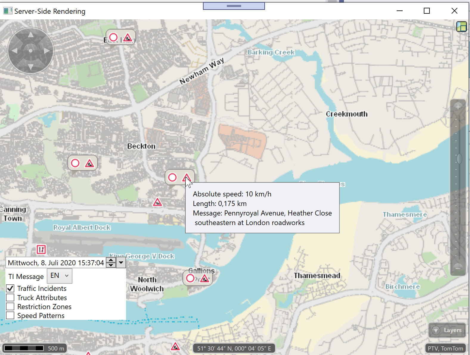

i have updated the sample
https://github.com/ptv-logistics/xserve ... tureLayers
for different message languages.
Note: This only affects the xServer messages itself, not the caption of the Tooltip-Labels (which are controlled by the CurrentUICulture), and not the transformation to imperial units.

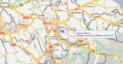

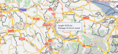

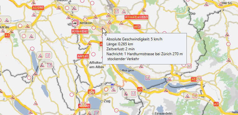

The language labels works for English and Deutsch ( German ) language in PTV xServer.Net control.
German:
English:
French:
However, any chance their will be support for other languages like French, Polish and Russian for caption of the Tooltip-Labels (which are controlled by the CurrentUICulture)? Or is their a way where we can implement and use it ourself?

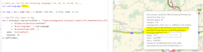

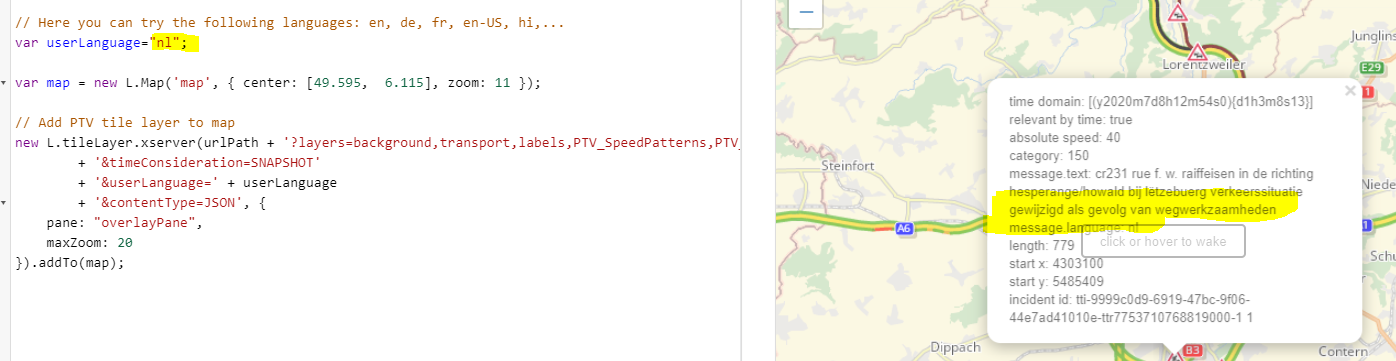

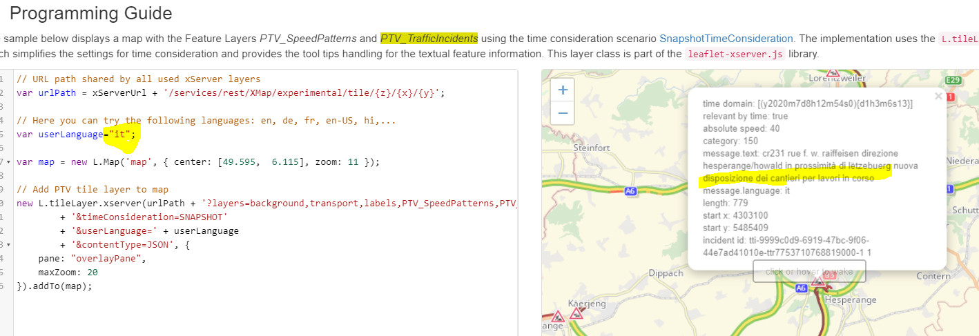

Good news: we have texts in other languages such as Italian and Dutch in xMap 2:
dutch on xServer2 showcase
italian on xServer2 showcase
The bad news: looks like the FeatureLayers usage in xServer1 does no support these two languages.
