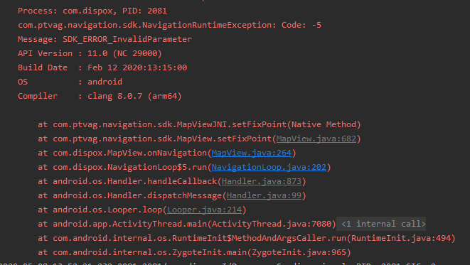

2. Changing the Map-Views' fix point via
setFixPoint(Position relPos)
doesn't seem to work with all values stated in the documentation (see http://navigator.ptvgroup.com/DE/sdk/ja ... .Position-). The maximum negative value on the y-axis seems to be -39. Exceeding this value leads to following SDK-error: SDK_ERROR_InvalidParameter. With position values of (0, -39) it works fine though.
Again, maybe I am missing something here?
