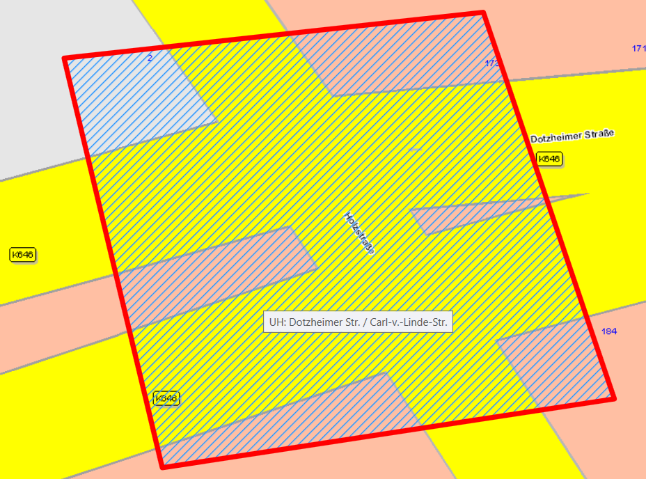

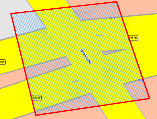

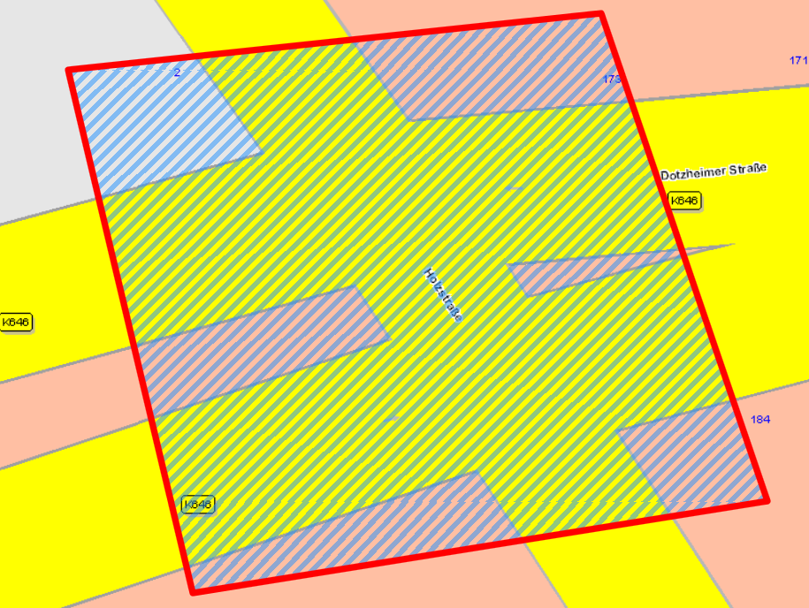

a quick explanation of the LocalOffset parameter. When set for a (Shape-)Layer, shakiness of objects and rendering-artifacts (e.g. wrongly aligned hatches) can be eliminated for very deep zoom levels (> 18).
You can set it if your layer objects are confined to a specific region. At intialization just set it to the center of this region. An example in the DemoCenter:

i must admit the last post caused some annoyance. The effect of the LocalOffset-property is hard to visualize with static images. The problem only occurs for zoom levels which go beyond the maximum level supported by xMap itself (> 20).
I made a video which should clarify this
