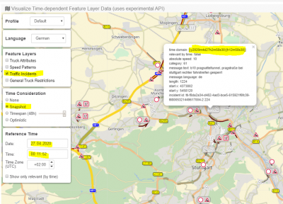

we want to use the PTV_TrafficIncidents feature layer.
But all icons are grey. Why?
We have to use the tile server.
https://s01-xserver2-europe.cloud.ptvgr ... cIncidents
Can you help?

Hello Christian,
think positive: that's not an error ;-)

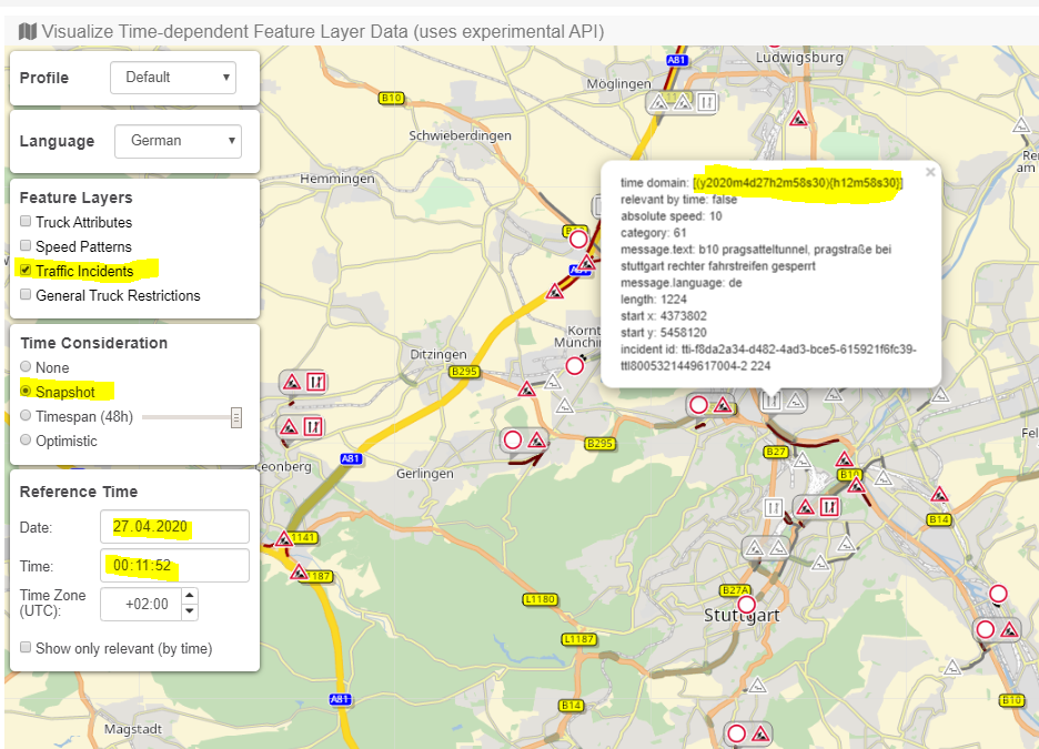

If an icon is displayed with a grey color this means that there is a time dependent traffic condition with a defined validity period and this interval does not match the TimeConsiderationMode of the map.
TimeConsideration of the map: SNAPSHOT 27.4.2020 - 00:11:00 (UTC+2).<br />Highlighted incident: [(y2020m4d27h2m58s30){h12m58s30}]<br />This means : the incident is valid from 2:58:30 on 27.4.2020 and lasts for &quot;12:58:30&quot; (till 4pm).<br />As the scope of the map is some hours before this incident it is displayed in grey.<br />Most of the grey icons are construction sites and therefore are given with a longer validity period.
This means : the incident is valid from 2:58:30 on 27.4.2020 and lasts for "12:58:30" (till 4pm).
So in other words this means that the data of the grey icons is outdated or you display a map with a future context and those blockings will no longer be relevant (usually short term incidents).
Check TimeConsiderationScenario to get more details about this.
