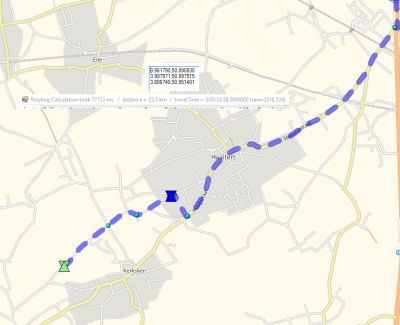

This might be a nitpicky question but I'm investigating the API & was testing the calculateRoute with some data and received some strange results. I'm wondering if this is a request issue, or missing data on your provider side.
(Doing a simple REST call with start location lat: 50.890830 lon: 3.981790 & end: lat: 50.951401 lon: 3.806740 )
(The call itself:
https://xserver2-europe-eu-test.cloud.p ... rredRoutes)
Now this ends up with this part of the polyline mapped to google maps + streetview of the issue.
In the first place I'm curious why it would route through that street as to get to the primary/secondary road it would be more efficient to just drive straight + the road it takes will not be possible to turn into.

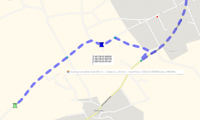

Posted: Thu Apr 09, 2020 10:26 am
- 25.3km / 2019 seconds
- 25.4km / 1998 seconds
I added some additional points to enforce specific directions.
The unwanted geometry is 100m longer but requires 20 seconds less than the one you want to get.
So if you push towards "driving time " (distanceTimeWeighting towards 0) you might get the track that you want.
But: The REST api does not support extensive parameters. If you want to access them you need to use WSDL/SOAP or JSON...
Feedback is welcome
PS: if the data situation is not up 2 date get in touch with your local support. The colleagues will gather the situation and forward it to our providers.
