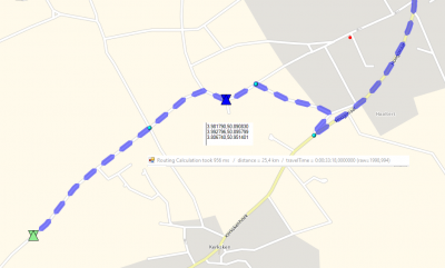

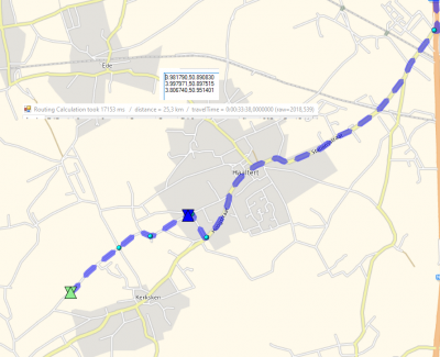

This might be a nitpicky question but I'm investigating the API & was testing the calculateRoute with some data and received some strange results. I'm wondering if this is a request issue, or missing data on your provider side.
(Doing a simple REST call with start location lat: 50.890830 lon: 3.981790 & end: lat: 50.951401 lon: 3.806740 )
(The call itself: https://xserver2-europe-eu-test.cloud.p ... rredRoutes)

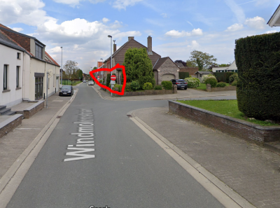

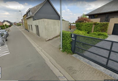

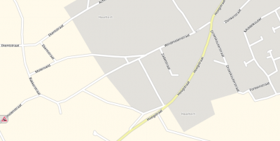

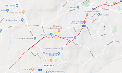

Now this ends up with this part of the polyline mapped to google maps + streetview of the issue.
In the first place I'm curious why it would route through that street as to get to the primary/secondary road it would be more efficient to just drive straight + the road it takes will not be possible to turn into.
Road used inaccessible by truck

Not sure whether I got it right but driving straight ahead would end up in a wrong direction of a one way road

ah hmm, that changed about 6 months ago (I live in the area), but still, the right turn before that forbidden sign would have been the route you take

The unwanted geometry is 100m longer but requires 20 seconds less than the one you want to get.
So if you push towards "driving time " (distanceTimeWeighting towards 0) you might get the track that you want.
But: The REST api does not support extensive parameters. If you want to access them you need to use WSDL/SOAP or JSON...

no signs, but physically it'll be impossible to go through, but I guess that truck attributes works based on signs/indications that certain roads are off limit? (Not too important, just found it weird that it would send a truck that way, trying to understand if my request/layers were correctly setup)
