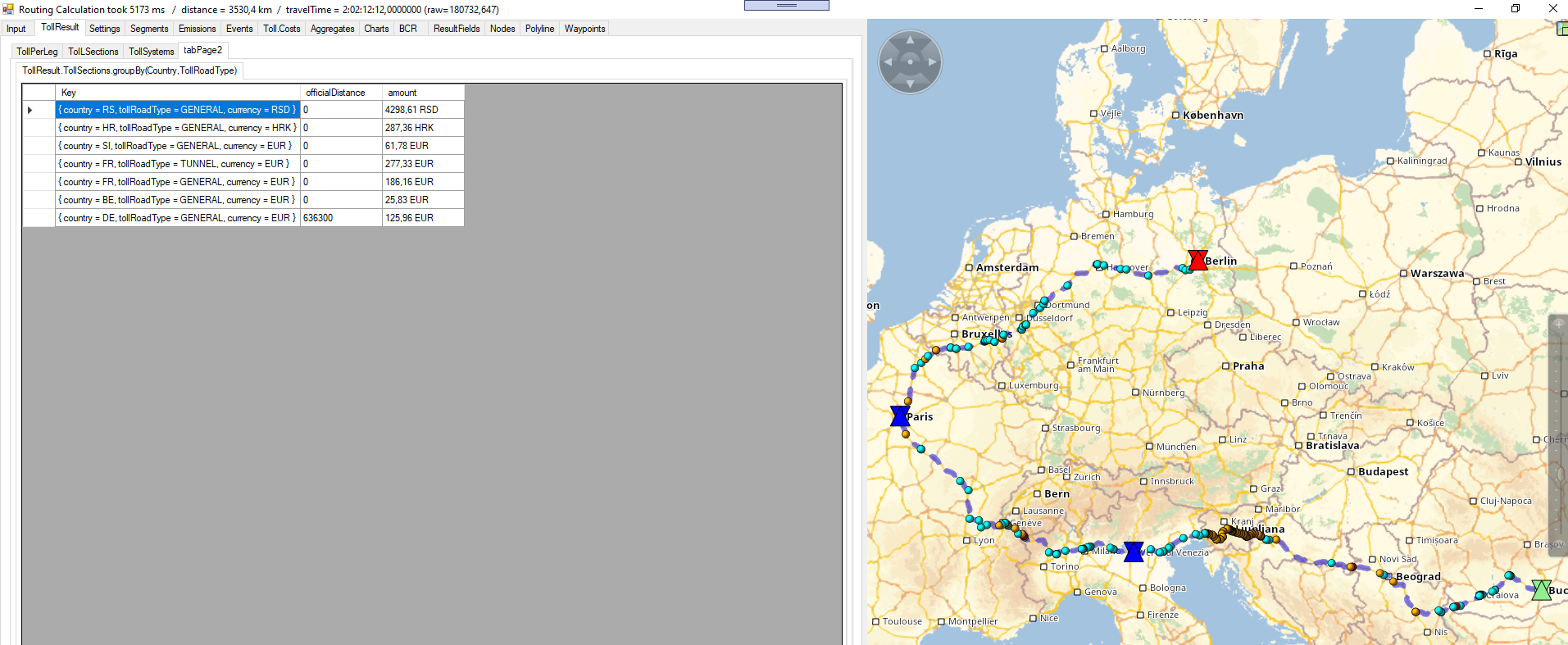

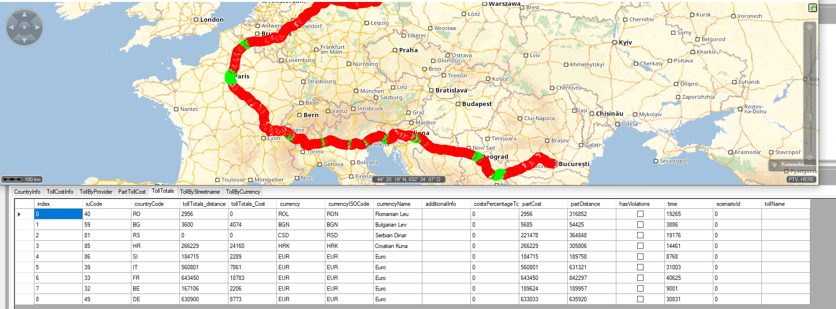

We're using the XRoute service and determined that there's a lack of tolls for some countries. For example:
We're giving the following points with a 40 tons truck: Bucharest - Verona - Paris - Berlin
The tolls we're receiving are for: Serbia, Croatia, Slovenia, France, Belgium and Germnay. As you can see Italy seems to have no tolls.
We've noticed that in particular, for Italy, it is always the case that we're not getting any tolls.
Please let us know how we can solve this problem.
