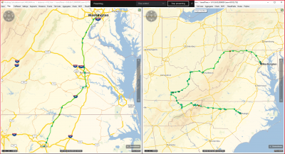

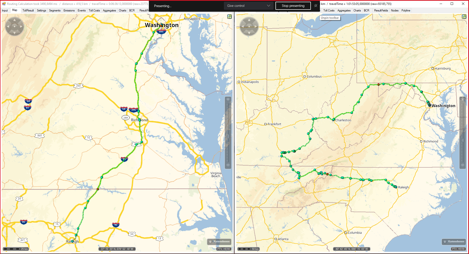

Yes we can: sample created with xServer2 (PTV cloud services):<br />Left map: Route takes direct way through the state of Virginia (418km)<br />Right map: Virginia is on the blacklist and therefore a large detour is taken (1'600km)

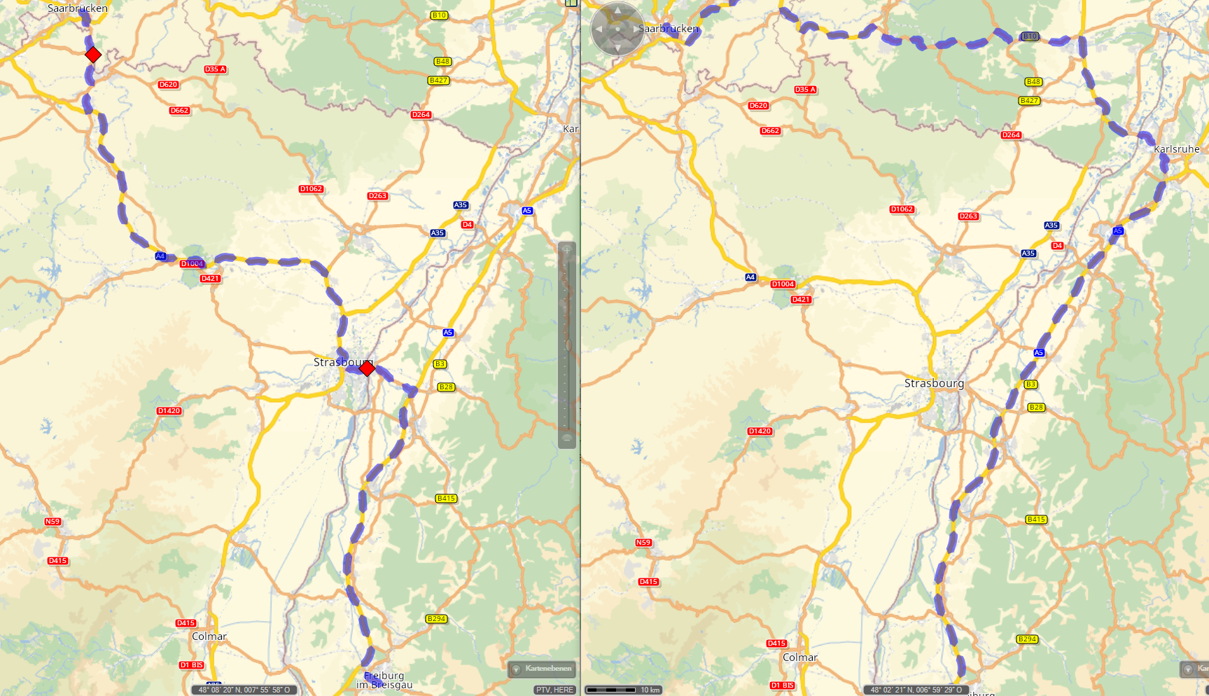

Both routes connect the German cities Saarbrücken and Freiburg.<br />Left map: route invalid because it leaves the country<br />Right map: route limited to Germany, detour
