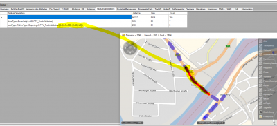

One of our mutual clients (is using: PTV xServer internet with API Version 1: PTV TLN Europe City Map (HERE)) has recently reported to us a certain irregularity when mapping the route through the border crossing in the Swiss city of Koblenz.
There is a restriction on the delivery of goods on this passage in one lane. After consulting your helpdesk, we managed to determine that the border crossing is closed between 10:00 PM and 5:00 PM ( att. Koblenz crossing.jpg ).
https://www.verkehrs-recht.ch/arbeits-u ... fahrverbot
It is therefore logical that it is not possible to calculate the route through this crossing if the ETA to this point is in between 10:00 PM and 5:00 PM. Based on the tests, I was able to determine the estimated time needed to cross the border crossing is 2h10m. I also instructed the client to take corrections into this type of situation by specifying the datetime of start time and destination time.

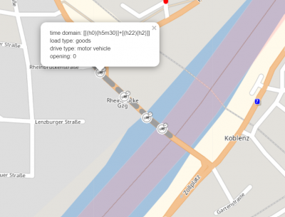

- As you already mentioned: there's a specific time dependent restriction near the border: "loadType=1|driveType=0|opening=0:PTV_TruckAttributes([[(h0){h5m30}]+[(h22){h2}]])" In other words: the segment is closed between 10PM and 5:30AM.
- This means the segment knows two conditions: (1) open between 05:30 and 22:00 or (2) closed otherwise.
- Especially "Closed" means "speed=0": therefore even when you allow violations: a 0-speed segment is not used, you'd get a detour
- Now if the dynamic router determines the time on segments with "given time is departure" this means you arrive either before the critical time (open with regular speed) or within the critical frame (detour)
- Depending on how yo wan to use this info in your business logic you can ask for "attributes in the response without considering them" with the following snippet:
<?xml version="1.0" encoding="UTF-8"?> <Profile> <Common coordinateFormat="OG_GEODECIMAL" language="en" majorVersion="1" minorVersion="0"/> <FeatureLayer majorVersion="1" minorVersion="0"> <GlobalSettings enableTimeDependency="false" enableVehicleDependency="true"/> <Themes> <Theme id="PTV_TruckAttributes" enabled="true" priorityLevel="0"/> <Theme id="PTV_TruckWaitingTimes" enabled="true" priorityLevel="0"/> </Themes> </FeatureLayer> <Routing majorVersion="2" minorVersion="0"> <Course distanceTimeWeighting="80" enforceShortestRoute="false"> <AdditionalDataRules enabled="true" layerName=""> </AdditionalDataRules> </Course> <Vehicle> <Physical> <Dimension height="55" heightAboveFrontAxle="80" length="1200" width="220"/> </Physical> </Vehicle> </Routing> </Profile> - This is also part of this post
