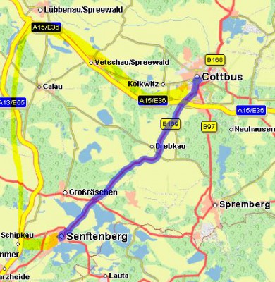

Hi Bernd ( and colleagues),
we faced a new 'problem'.
Some colleagues gave me a hint, that the B169 between Cottbus and Senftenberg is used although it`s blocked for trucks since March 2019.
https://www.lr-online.de/lausitz/cottbu ... 54616.html
Pls. are you able to check, if that`s an card-error.
maybe we missed an update?

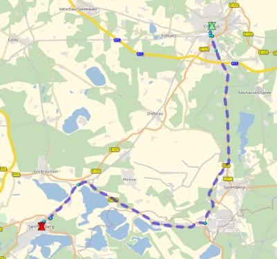

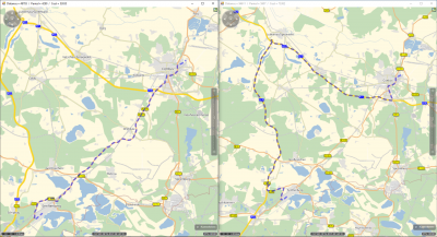

Re: Blocked Road (B169) is used
new 2021_cards are considering the restrictions on B169 between Cottbus and Senftenberg.
Thanks,
Sebastian
