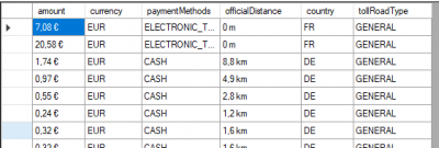

Some quick info:
http://devblog.ptvgroup.com/2020/01/23/ ... available/
You can now test the detailed toll for France and Germany in the cloud.
Here's also a sample JSON request which causes the server to produce the detailed toll values. Use the raw request runner to play with coordinates and storedProfile to check the impact ;-) Be aware that as of today the detailed toll will cover France/Germany but other countries will be added to the services later this year.

AixEnProvence-Berlin.response-with-detailed-Toll.txt
The sample's response incl. various toll elements
(1.82 MiB) Downloaded 516 times
Feel free!

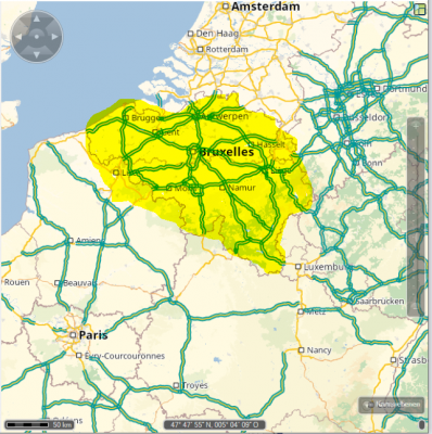

Some news!!
Dear all,
the first layers of detailed toll are tested and released. The layers are activated on Content Update Service (CUS) on March 16, 2020 and include the following countries:
- Slovenia
- Croatia
- Serbia
- Norway
- Belgium
Toll available after the update
Please Note: the layers are only referenced to World City Map 2020.2H as well as Europe City Map 2020.2H and can only be used with these maps.

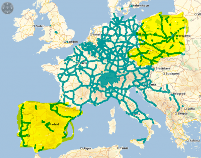

New toll data is available for the following countries:
- Poland
- Portugal
- Czech Republic
- Spain
Spain, Portugal, Poland and Czech Republic
http://devblog.ptvgroup.com/2020/05/28/ ... available/

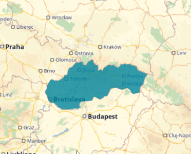

Slovakia: This scenario includes new tariffs and new toll roads from January 2020. This scenario replaces the previous ‘Slovakia January 2019’ scenario.
Toll Update (2020_09) Slovakia
Posted on August 3, 2020 by Saskia Oestreich
Slovakia
