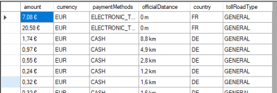

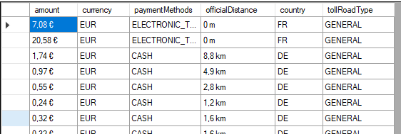

Sample data aggregated by country and roadtype
Sample data as linear list

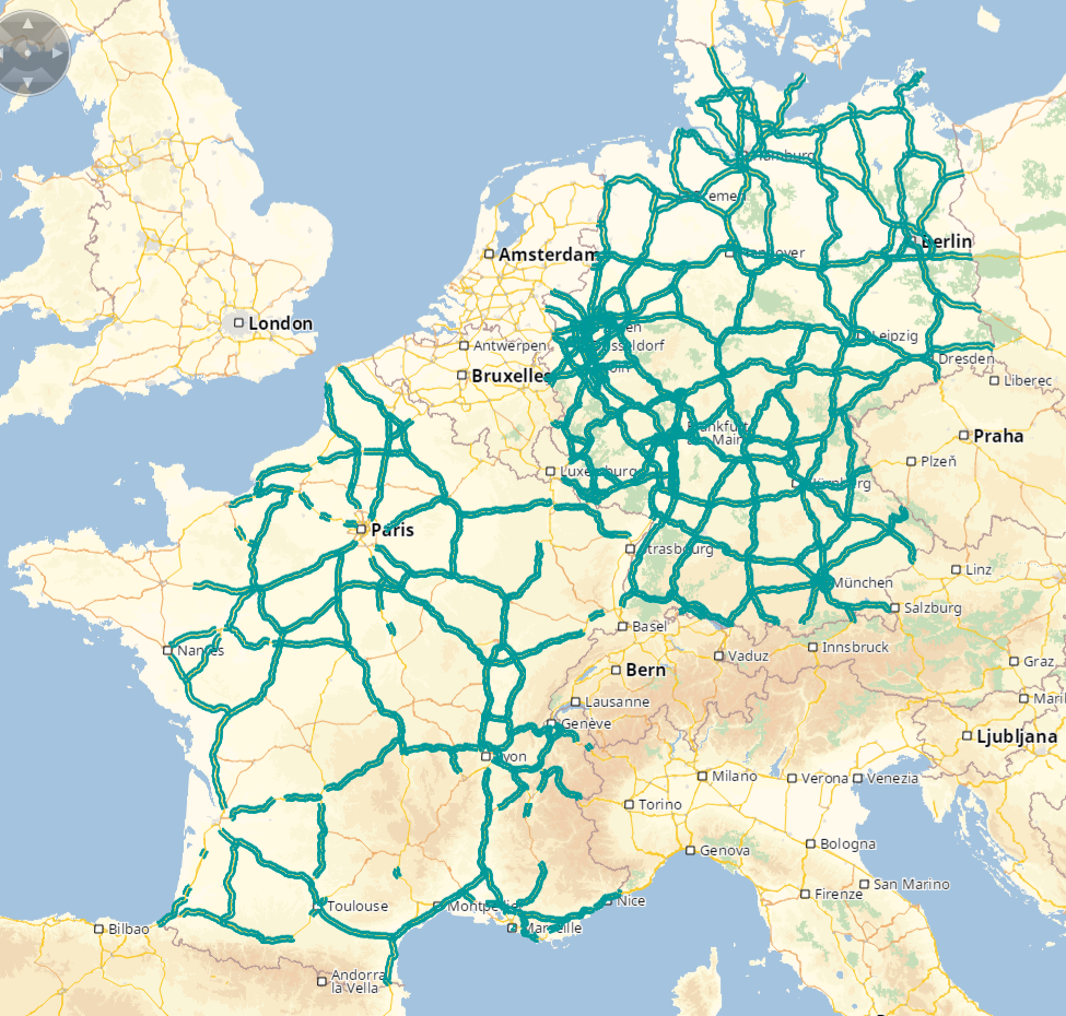

Some quick info:
http://devblog.ptvgroup.com/2020/01/23/ ... available/
You can now test the detailed toll for France and Germany in the cloud.
Here's also a sample JSON request which causes the server to produce the detailed toll values. Use the raw request runner to play with coordinates and storedProfile to check the impact ;-) Be aware that as of today the detailed toll will cover France/Germany but other countries will be added to the services later this year.

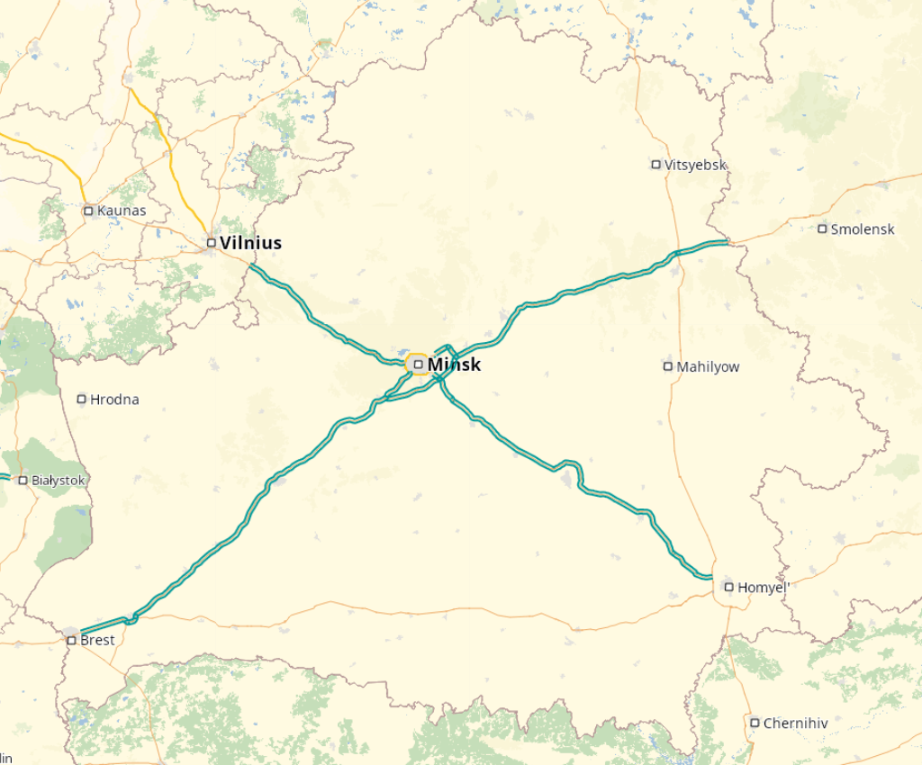

Some news!!
Dear all,
the first layers of detailed toll are tested and released. The layers are activated on Content Update Service (CUS) on March 16, 2020 and include the following countries:
- Slovenia
- Croatia
- Serbia
- Norway
- Belgium
Toll available after the update
Please Note: the layers are only referenced to World City Map 2020.2H as well as Europe City Map 2020.2H and can only be used with these maps.

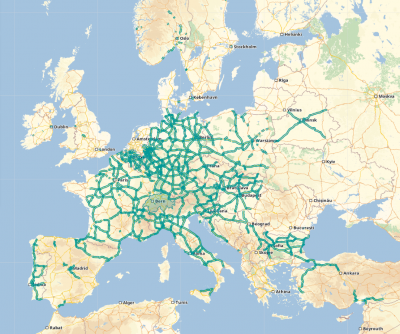

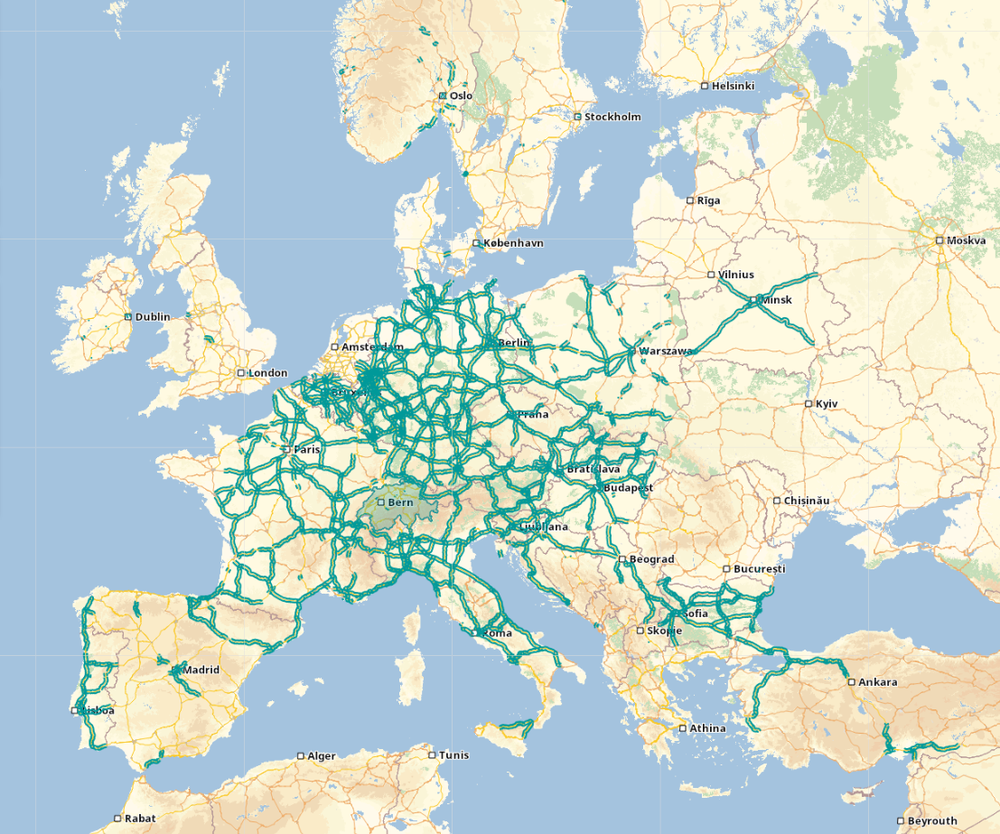

And further countries are now part of the detailed toll data (on premise and in the cloud): we added
- Switzerland
- Great Britain
- Italia
- Norway
- Sweden
We activated the detailed toll layers for Switzerland, Great Britain, Italia, Norway and Sweden referenced to PTV Europe / World Map Premium 2020.2H today, on May 05, 2020 on our Layer Delivery Server (LDS). Now, it is possible to download detailed toll layers via Content Update Service (CUS).
Further details are available at the Developer Blog!

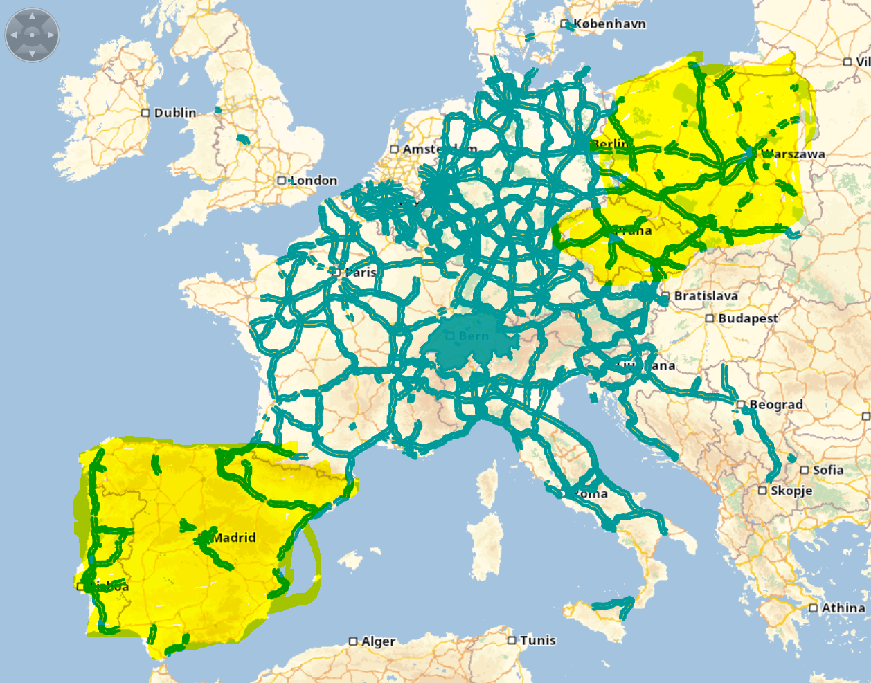

New toll data is available for the following countries:
- Poland
- Portugal
- Czech Republic
- Spain
Spain, Portugal, Poland and Czech Republic
http://devblog.ptvgroup.com/2020/05/28/ ... available/

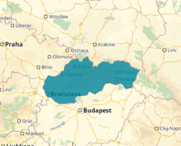

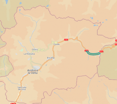

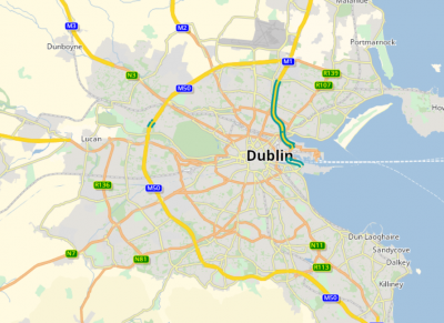

Re: PM statement: Roadmap of "new" toll data (xserver2)
And some more good news from product management (Saskia):

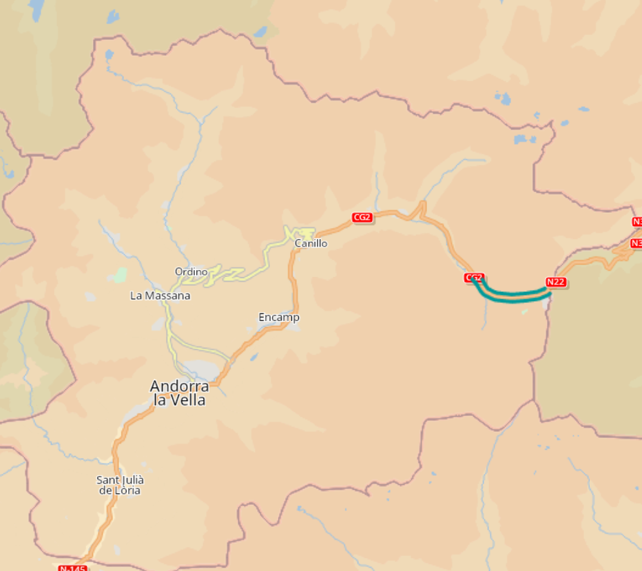

Detailed Toll for Slovakia, Ireland, Romania and Andorra available
We activated the detailed toll layers for Slovakia, Ireland, Romania and Andorra referenced to PTV Europe / World Map Premium 2020.2H, on July 23, 2020 on our Layer Delivery Server (LDS). Now, it is possible to download detailed toll layers via Content Update Service (CUS).
Please remember: to use the detailed toll on premise you need to follow these steps:
Step 1: Activate the detailed toll download via content update service in you xserver.conf.
core {
contentupdates {
content {
detailedToll {
enabled = true
providerNames = [ "here" ]
countries = [ ]
Step 2: Enable the detailed toll calculation in the xserver.conf or in your request.
xroute {
tollOptions {
useDetailedToll = true
Andorra
Andorra
Romania
Romania
Ireland
Ireland
Slovakia
Slovakia

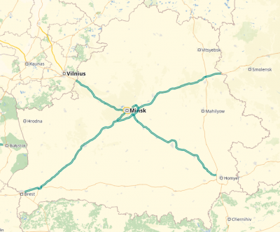

current coverage europe on https://xserver2-europe-eu-test.cloud.ptvgroup.com/
Check the showcase!
Detailed Toll for Belarus available
Posted on November 17, 2020 by Saskia Oestreich
We activated the detailed toll layers for Belarus referenced to
PTV Europe / World City Map Premium 2021.1H, today on our Layer Delivery Server (LDS). Now, it is possible to download detailed toll layers via Content Update Service (CUS).
