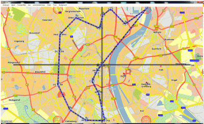

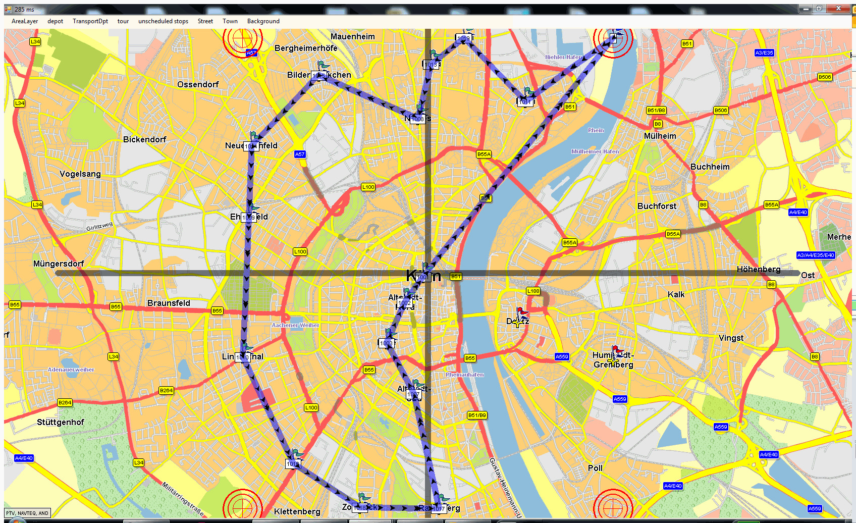

Have a look at the attached screenshots:
  • Each customer has an individual servicePeriod of 5 minutes
  • Each quadrant is simulating an area and whenever I'm entering a new quadrant I want to spend 60mintes extra for the first customer to be delivered over there.
  • As you can see with the polygon lines: the orders 1011,1008, 1010, 1017, 1007 are such hits.
  • Though I have already visited area SouthWest before (subsequence 1010, 1016, 1018) I have to spend another 60 minutes for the second entry (1007,1003,1002...).
The map with the quadrants

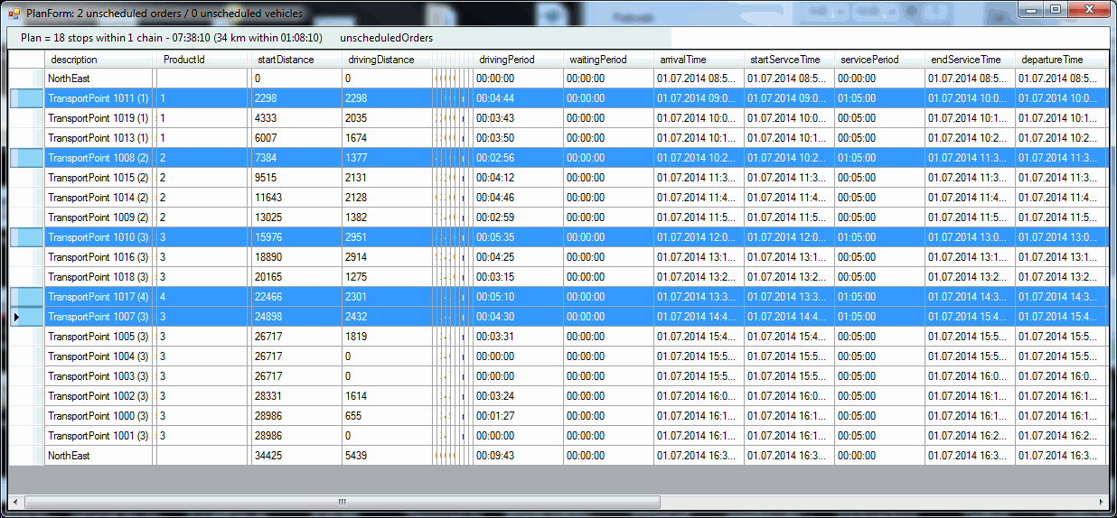

The schedule
The schedule
You will find this data in the schedule where the service period for these points is not 5 minutes but 1h:05mins.
