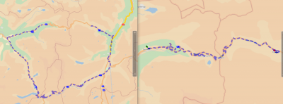

- Route from Gadmen to Färningen (tomtom map).
LEFT: blockedInWinterMalus =0
RIGHT: blockedInWinterMalus=2600

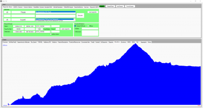

Albula Pass (
wikipedia)
from CH-Thusis to CH-La Punt.
- 2022.2H
left: blockedInWinter=0
right: blockedInWinter=2501
- elevations

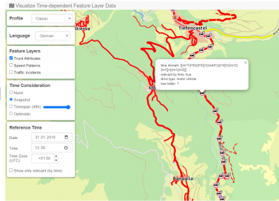

Here's a
quick update for xServer2 users:

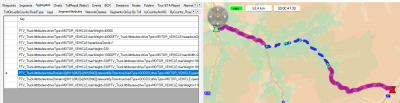

the winter blockings seem to be available as regular truck attributes (FeatureLayer PTV_TruckAttributes) with a time dependency, e.g. from 1.11.-30.4.:
![TruckAttribute xRoute2.png (684.68 KiB) Viewed 7208 times Biweekly sample... routes started at 1.1.2022, 14.1.2022, 28.1.2022.... In this case the routes take a detour according to the following TruckAttribute (2023.1H map):<br /><br />PTV_TruckAttributes=timeDomain=[[(M11){M2}]+[(M1){M4}]];relevantByTime=true;loadType=GOODS;driveType=MOTOR_VEHICLE;opening=0PTV_TruckAttributes=driveType=MOTOR_VEHICLE;maxWeight=11000](./download/file.php?id=1925&t=1)
- Biweekly sample... routes started at 1.1.2022, 14.1.2022, 28.1.2022.... In this case the routes take a detour according to the following TruckAttribute (2023.1H map):
- 2023.1H
Attention: different pass - different time constraint:
- Blocked from 16.11 - 14.04. (ok, a bit challenging to read...)
- From CHE-Tiefencastel to CHE-Silvaplana
So there's no "blockedInWinter" flag but a time dependent blocking/opening.
