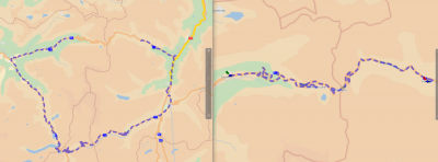

Re: Mountain passes
Route from Gadmen to Färningen (tomtom map). <br />LEFT: blockedInWinterMalus =0<br />RIGHT: blockedInWinterMalus=2600

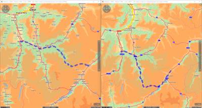

Re: Mountain passes
Albula Pass (wikipedia)

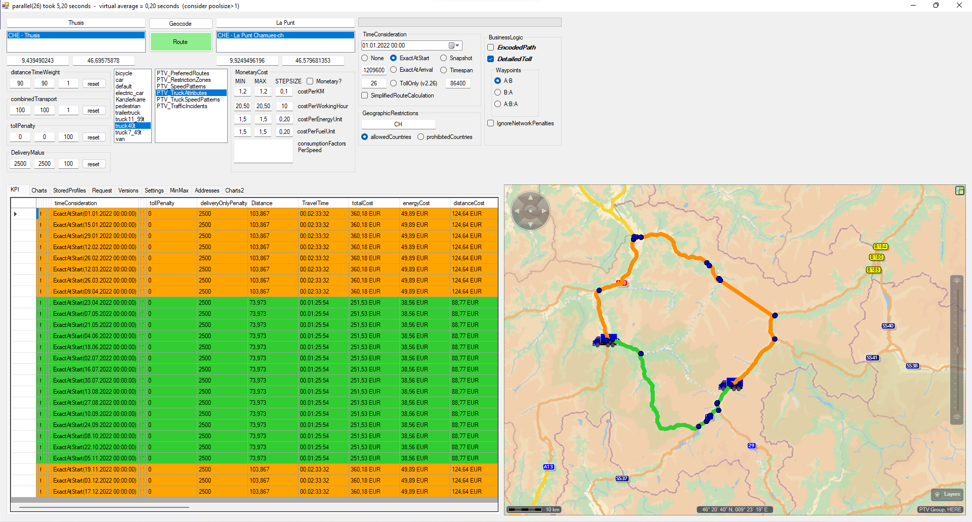

from CH-Thusis to CH-La Punt.
2022.2H<br />left: blockedInWinter=0<br />right: blockedInWinter=2501
2022.2H

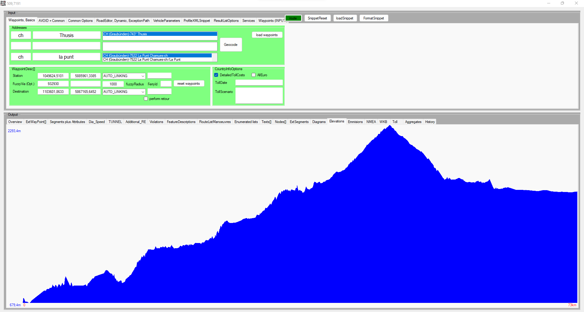

elevations
elevations

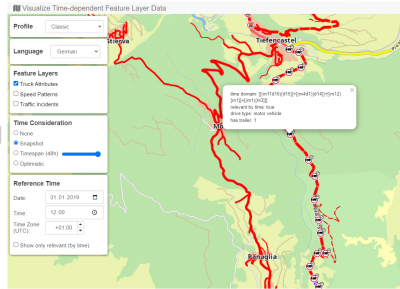

Here's a quick update for xServer2 users:
the winter blockings seem to be available as regular truck attributes (FeatureLayer PTV_TruckAttributes) with a time dependency, e.g. from 1.11.-30.4.:

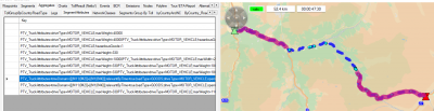

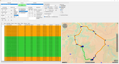

Biweekly sample... routes started at 1.1.2022, 14.1.2022, 28.1.2022.... In this case the routes take a detour according to the following TruckAttribute (2023.1H map):<br /><br />PTV_TruckAttributes=timeDomain=[[(M11){M2}]+[(M1){M4}]];relevantByTime=true;loadType=GOODS;driveType=MOTOR_VEHICLE;opening=0PTV_TruckAttributes=driveType=MOTOR_VEHICLE;maxWeight=11000
2023.1H
2023.1H

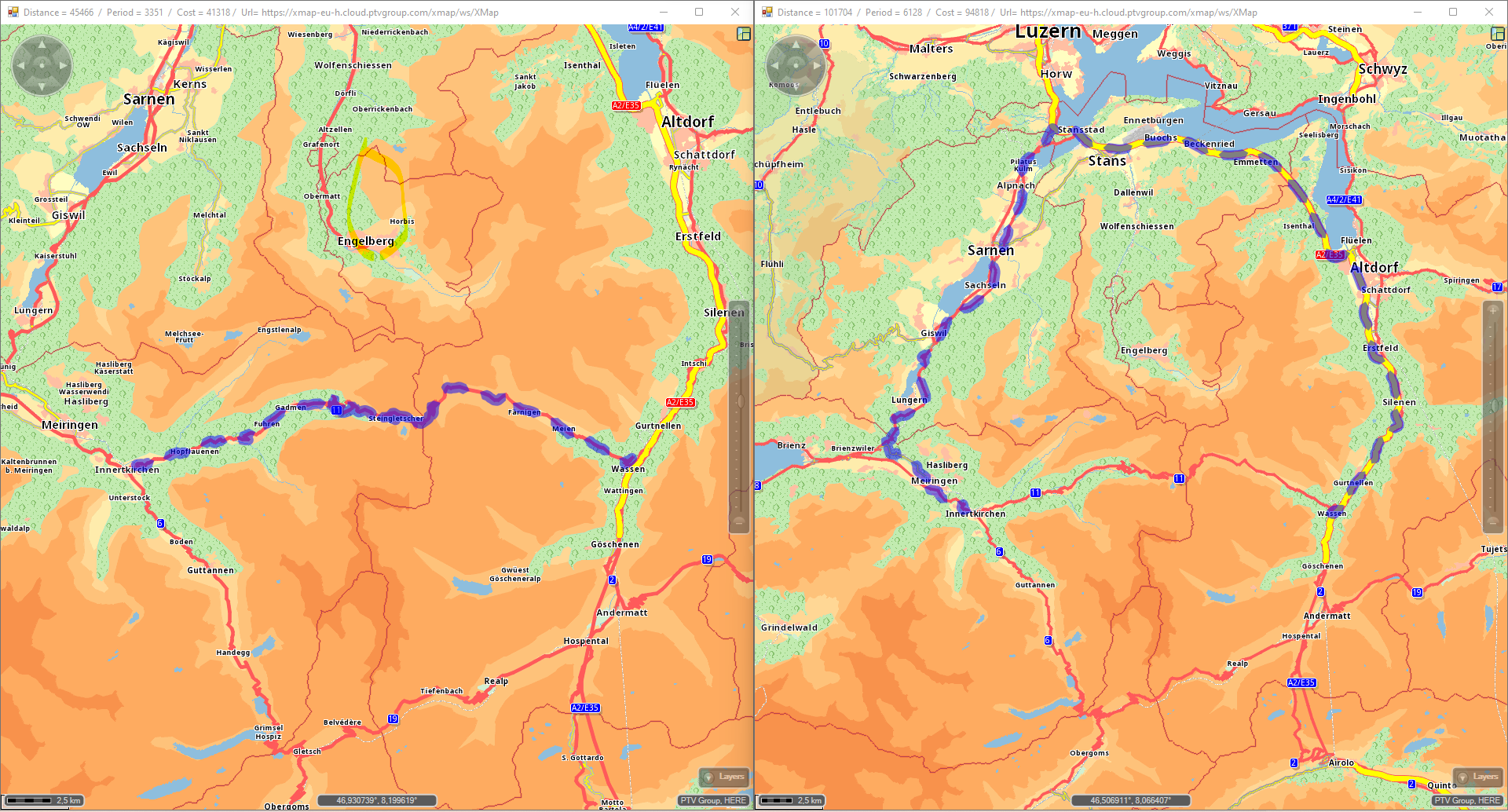

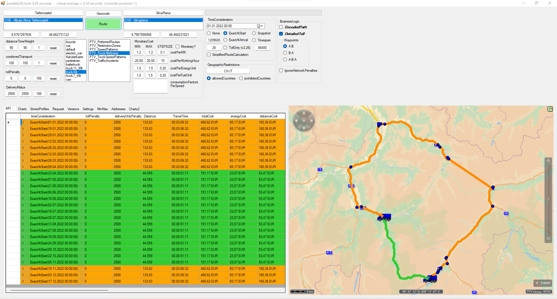

:!: Attention: different pass - different time constraint:
Blocked from 16.11 - 14.04. (ok, a bit challenging to read...)
From CHE-Tiefencastel to CHE-Silvaplana
:idea: So there's no "blockedInWinter" flag but a time dependent blocking/opening.
