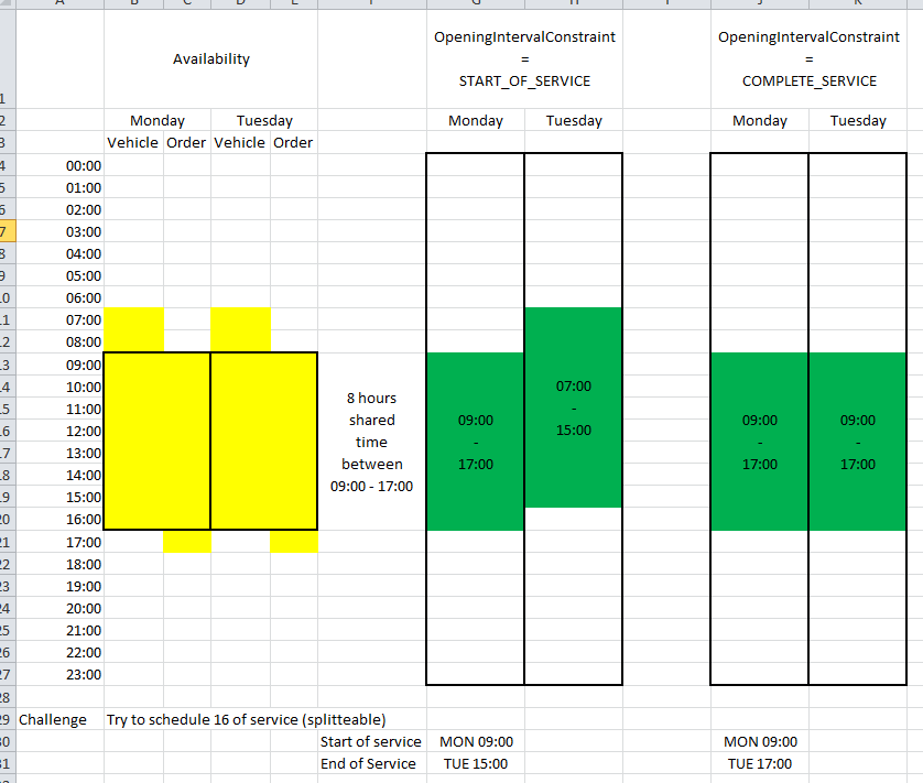

Well let's have a look at the plot (reduced to a sufficient setting):
  • The vehicle is available MON to FRI between 07:00 and 17:00 (10 hours each day).
  • The stop to be visited is open MON to FRIDAY between 09:00 and 18:00 (9 hours each day)
  • So the common interval is 09:00 to 17:00 each day (8 hours each day)
  • I want to place 16 hours of service (splitteable).
What I expected to happen: two days of service with each part in the common 09:00 - 17:00.
What happened instead: the service at the second day end at 15:00 in the afternoon.
Visualization of the two possible result structures
First impression: That's a bug
But: it isn't a bug... it happens like this because the default value for OpeningIntervalConstraint is START_OF_SERVICE:
Once we started a service in the common interval (Monday 09:00) we no longer take care of the customers opening times. This also happens when a service is splitted over several intervals and this is why the service is continued tuesday morning 07:00 when the next WORKING interval starts. The second partial service is therefore 07:00-15:00 and this is definetly ok.
If the splitteable service is not 16 hours but 24 hours we get
MON 09:00 - 17:00 / TUE 07:00 - 17:00 / WED 07:00 - 13:00 = 8+10+6 hours in START_OF_SERVICE mode
MON 09:00 - 17:00 / TUE 09:00 - 17:00 / WED 09:00 - 17:00 = 8+8+8 hours in COMPLETE_SERVICE mode
