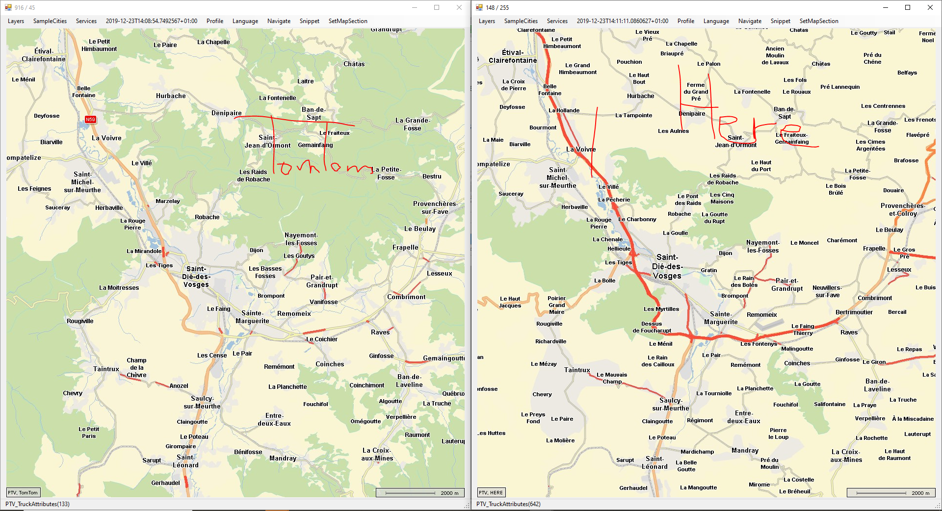

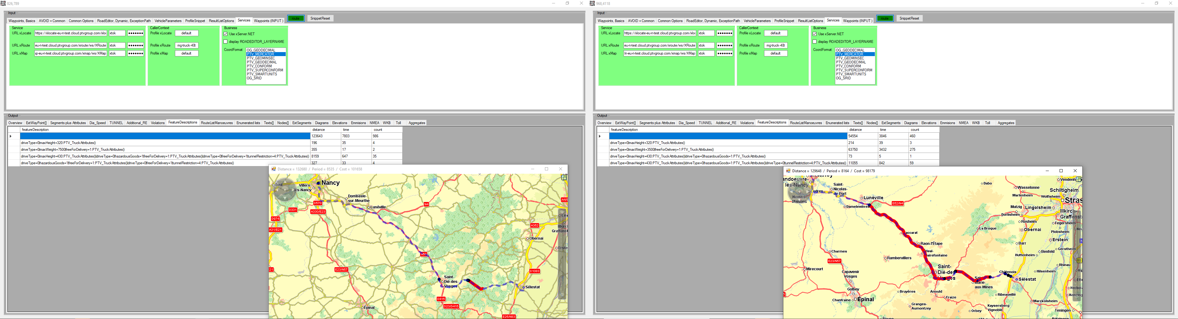

Hello Ibrahim,
I just looked into this topic. First of all the TRUCK ATTRIBUTES data coverage in the region depends on the map provider: HERE has many more attributes compared to TOMTOM. I recommend to take a close look into this together with Amar / France who is your assigned consultant. If he needs further assistance he can get back to me.
Best regards from Germany,
