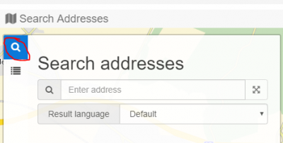

- click the magnifier to jump into the single field search (not obvious if you ask me)
