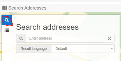

the current xLocate 2 does not provide a dedicated suggestion function. Nevertheless the codesamples simply perform a complete geocoding with each character being entered.
Maybe not meaningful with just 2-3 characters but how about giving it a try after the first 4 or more chars?
