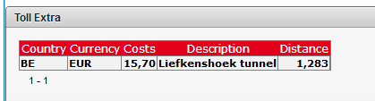

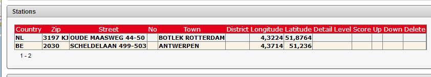

another problem (or mistake in my own configuration).
We enabled the Basic Data Rules/Toll/extraTollMalus,
but there is no difference within the result, when the values are changed (-99,2500,2501)
coordinates:
request
request
Extra Toll:
extra_toll
extra_toll

Posts: 318
Re: Routing through a tunnel with extra toll
Sorry for the late reply. The documentation on this part is not completely correct. Bridges and Tunnel are not classified as extra toll in our data but as special toll. We don't have a parameter for avoiding special toll specifically. They will be avoided by the regular tollMalus but that one goes for all toll roads.
