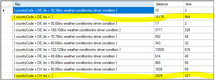

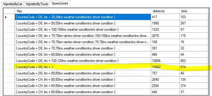

The following two screenshots show a sample of two routes calculated on HERE and TOMTOM. The yellow lines show the distances and periods in the countries where a segment has no limits in the data.
Be aware that this isn't representative.
TOMTOM based result
TOMTOM based result
HERE based result
HERE based result
