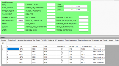

A quick question for you: how to deal with xRoute 1 and new german toll; co2EmissionClassEU is not present. So, is it based on date + "parameter": "EMISSION_CLASS"? I tried without success.
Kind Regards
Re: New toll tarrifs for Germany (dec2023 / july2024)
Posted: Mon Dec 11, 2023 4:00 pm
Hi Daniele,
all xRoute1 routings with a toll date after 1.12.2023 will apply CO2EMissionClassEU=1... (check the posts above).
Let's be very specific:
  • If you mean "EMISSION_CLASS" such as EURO_1, EURO_2, ... EURO_5, EURO_6... the prices will change between the classes. But the will ALL be based on CO2EmissionClassEu=1.
    Also some example based on xRoute1 (prod HERE) ... Same waypoints and profile, I just iterated over the EMISSION_CLASS = EURO_0, EURO_1....
  • In xServer2 the EMISSION_CLASS is com.ptvgroup.xserver.vehicleprofile.EmissionStandardEU
  • And the CO2EmissionCLassEu exists as a new property of VehicleProfile.Engine:
