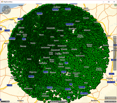

The computatio of a 6000x6000 matrix can be done within less than 1 minute (my local example took 45 secs), but my stomach tells me we are on a wrong path.
Let's get several steps back:
Imagine you could wish a blackbox function where you provide a given input and describe the required output.
From a functional usecase point of view (forget each method of xServers for a moment):
how would the signature of the function look like?
I think I might provide a better solution for the original task then...
- coverage of 7000 (!) locations around Paris. Computation time: 60 seconds.
