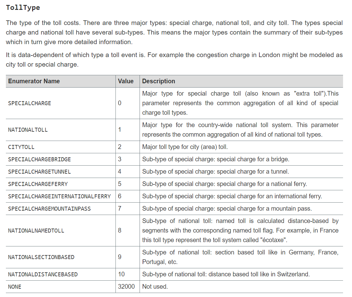

Every route from Calais to Folkestone via Eurotunnel inkludes toll price.
Is there a way to configure route parameters that way that list with toll price will be without eurotunnel cost ?

Hello Krzysiek,
so do you want to exclude the tunnel price from the list? If so: what is the generic criteria /expectation?
How about filtering SPECIALCHARGE? Or aggregating only those toll classes that are required?

Thanks for the reply.
I didn't know that there is a SPECIALCHARGETUNNEL tolltype.
filtering will do the job perfectly.

OK, please consider the following info, too!
