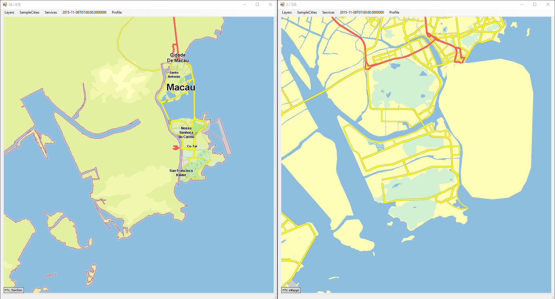

Something weird going on, because I thought these areas were not covered:
Macau
Macau
Any idea why I don't see China main land detail?

To which server are you connecting? I’m guessing to api.cloud.ptvgroup.com, which serves the PTV World City map. China Is not covered in this map. For china you need to connect to china.cloud.ptvgroup.com

left: https://api-test.cloud.ptvgroup.com/xmap/ws/XMap<br />right: https://china.cloud.ptvgroup.com/xmap/ws/XMap

Thanks Joost and Bernd, I was mistakenly using api-eu instead of china. It's working now.
