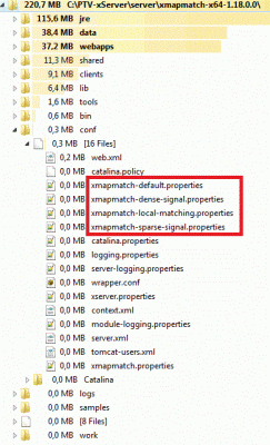

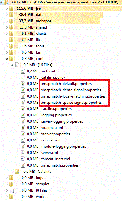

Should I see these files somewhere in my project directory, or are these downloadable from the web?

- Posts: 3075
Re: Adjusting an existing path to the map
Hello Joao,
depends:
depends:
- Local installation
in case of a local installation you should find the files in the CONF folder, see attached screenshot of my laptop. - xServer internet aka xSaaS
If you use xServer internet aka xSaaS you need to know the names of the available files and you can't add further files because the configuration is fix.
