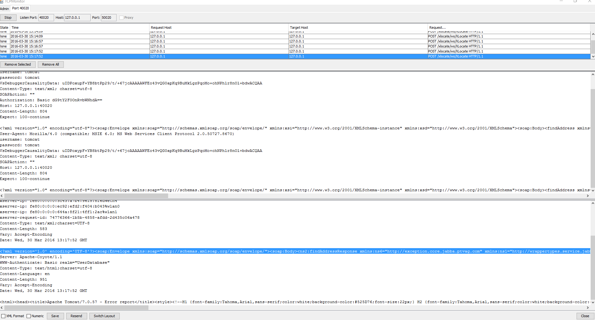

looks like this is a framework issue. I made some tests on my local machine but I need some backend experts for further statements. I already triggered them but due to easter vacancies it might take some days (most of them are out-of-order this week).
PS:
I used a C# client where I override some web request objects.
A single call in the source produces 2 succeeding XML postings. Strange.
Looks similar to what you describe: one malicious response due to failed authentication and one successful one
Used PORTMON tool to capture traffic. Within a single HTTP conn there are two XML requests send - and two responses received: one is an empty geocoder result list (successful), the other one is an exception
