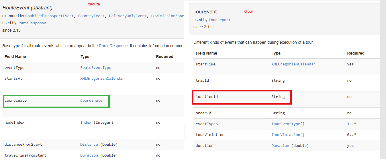

When we call xTour/planTours with a driver breaks configuration, the response may contain planned breaks. However, the response does not include the actual coordinates where the break occurs. Instead, it only provides the driving time from the previous stop.
This creates a limitation in our system because we cannot display the driver break location on our map.
While investigating alternative approaches, we noticed that xRoute/calculateRoute does return coordinates for breaks (under Route events):
Based on this, we considered the following approach:

We tested this approach using the Raw Request Runner, and the results were consistent:
xRoute placed the breaks at exactly the same times as those generated by the original xTour request, while also providing the coordinates we needed.
:?: Our question is the following:
  • Is this the recommended approach according to the API design, or have we possibly missed a simpler or more direct method for obtaining break coordinates when using xTour/planTours?

your approach sounds valid to me. Please be aware of the following comments:
  • xTour2 is not aware of underlying geometries of routes - it simply uses the traveltimes / distances given by xDima2's matrices. Therefore xtour2 cannot return exact positions.
  • Under some circumstances the traveltimes / distances of a Matrix based call could differ from the KPIs returned by a 1:1 routing. This is in fact quite often happening when you apply CONVENTIONAL routing instead of HIGH_PERFORMANCE_ROUTING. :!: To minimize gaps you are recommended to use the same HPR for the xDima2 and xRoute2 calls.
