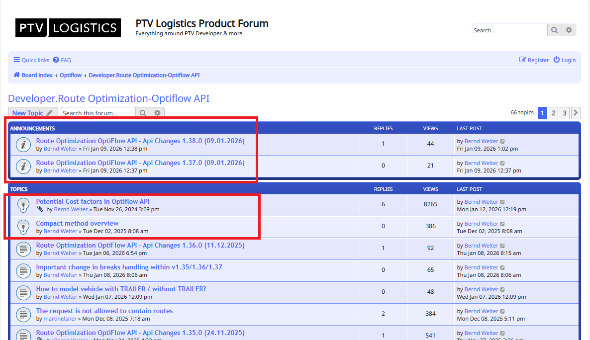

  • Route Optimization Optiflow Forum: There's a dedicated subforum for questions all around the Route Optimization Optiflow API. :idea: We recommend to subscribe to this category to stay informed about latest news!
    • Announces new API versions
    • Keeps generic posts on top
    • Provides many articles about questions/answers, new features and describes error codes (and solutions)

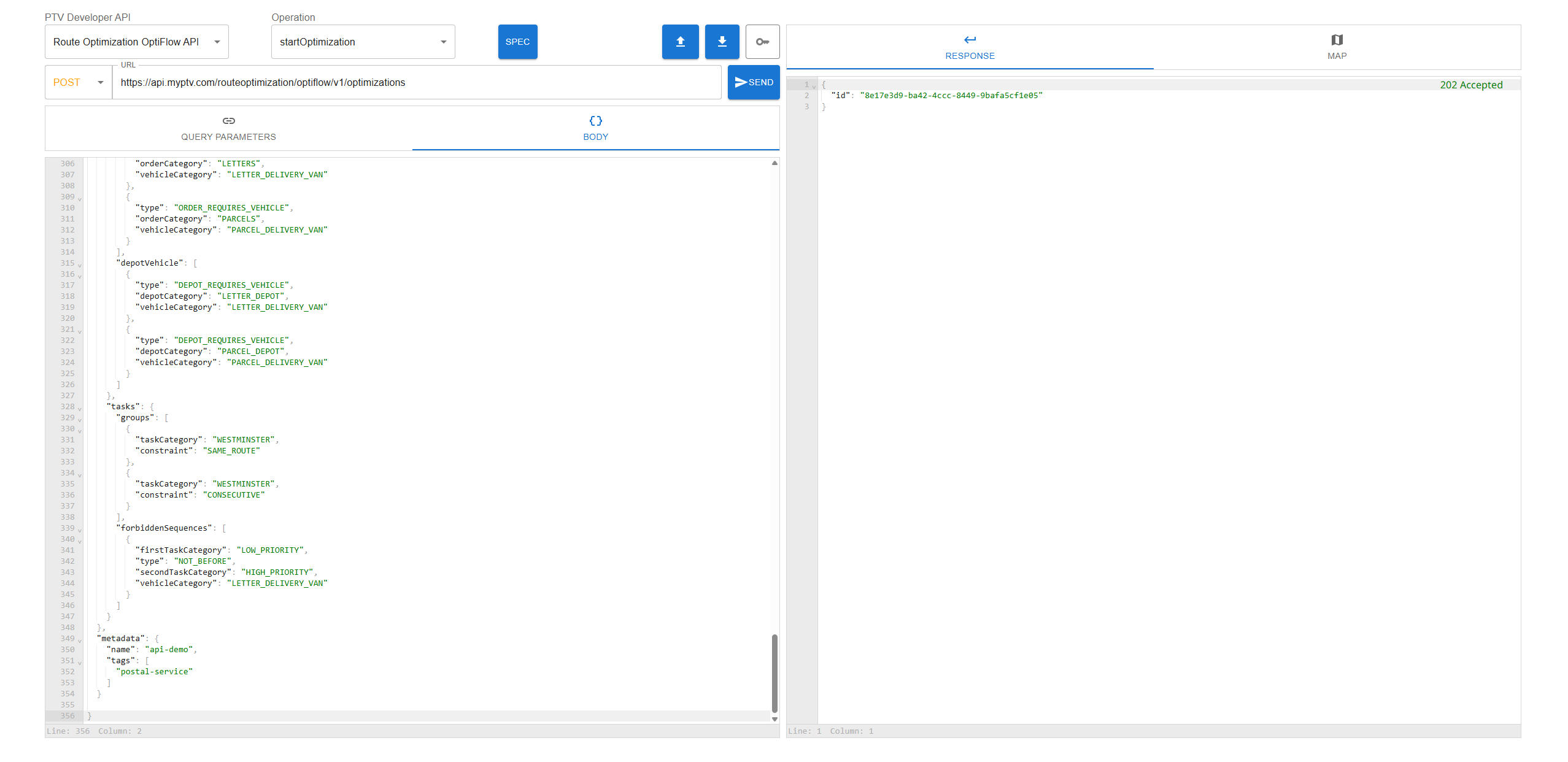

  • Request Runner: With this sample appölication you can process native JSON messages against all the different services.
    • Select the API and Method
    • Enter the body / the params
    • Send
    • :!: For async methods: switch to progress methods and gather the updates status / final result.
