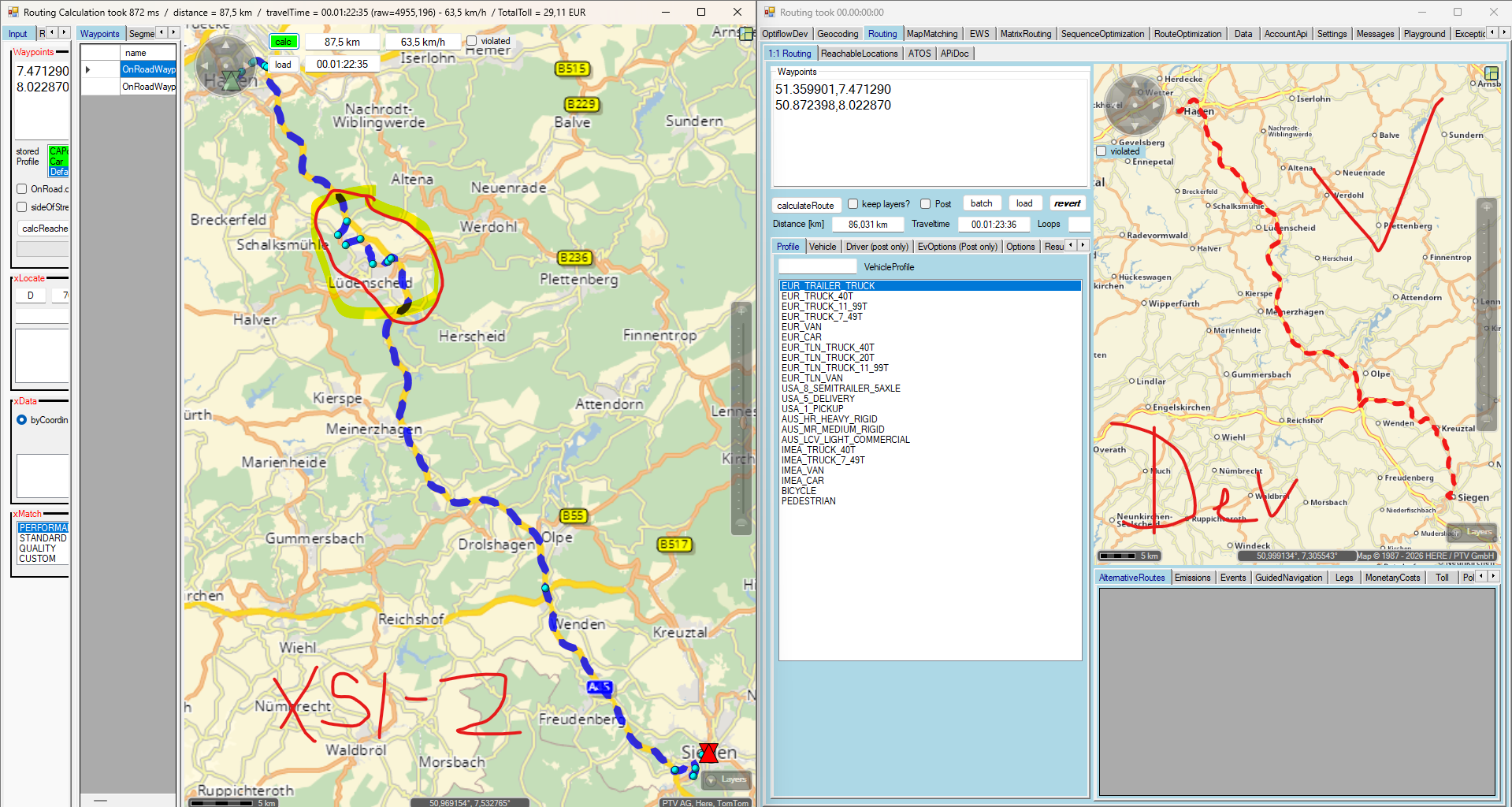

    Screenshots provided through test applications. <br />Left: PTV xServer Internet 2 (update not applied yet, 8.1.2026)<br />Right5: PTV Developer: update applied and layers will be enabled under the hood ;-)

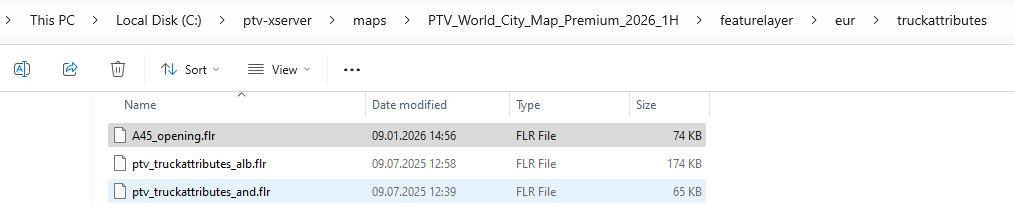

For xServer2 OnPremise admins with 2026.1H maps:
Deploy the patch in the proper subfolder!
