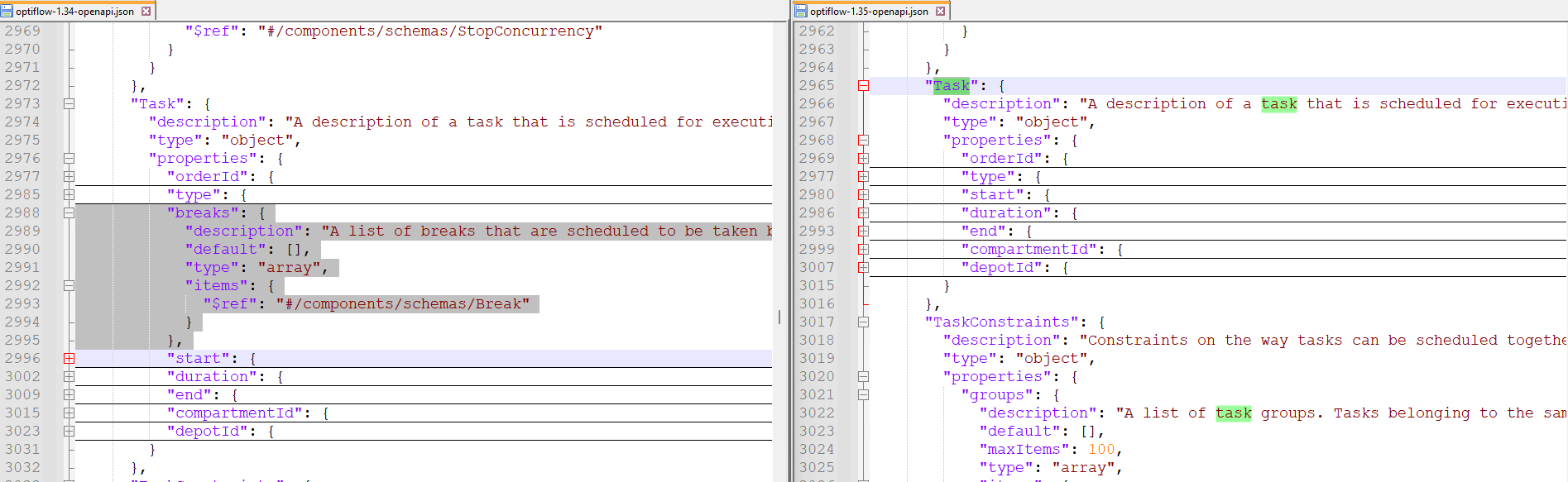

Route Optimization OptiFlow API1.35.0FEATURE24.11.2025Breaks are no longer scheduled between tasks at the same stop. Therefore there are no more breaks at Task and Appointment.

So here comes some "learning" from a player who probably wishes he had known this (had some stress today): feel free to port this info to your brain ;-)
  • The player created a business logic based on a manual JSON string handling which expected the element breaks as it was defined in 1.34 -though this was an OPTIONAL element and returned as
    "appointments":[
       "breaks": [],
       "waitingDuration": 0,...
  • When we removed the element according to the spec below... the response now no longer returns a property "breaks"...
    "appointments":[
    When he tried to access this element he faced some "doesn't exist!" error...
Therefore please always remember:
THE MACHINE OPEN API SPEC is the reference! - If we mention such a topic in the release notes take a few seconds to derive the consequences for your application!
