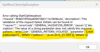

I just crashed into this error message and from my perspective you should at least be aware of the underlying concept.
This is not a bug.
  { "traceId": "...",
    "description": "The validation of the request failed. Details can be found in **causes**.",
    "errorCode": "GENERAL_VALIDATION_ERROR",
    "causes": [
      { "description": "The value of a string parameter does not satisfy the required pattern.",
        "errorCode": "GENERAL_PATTERN_VIOLATED",
        "parameter": "$.metadata.tags[1]",
        "details": { "pattern": "^[a-zA-Z0-9_-]{1,36}$" }
    "details": {}
Now here's what caused this error : my metadata tags have been set to this. Look at the second tag which is set to "pOrders:0".

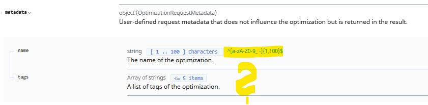

The human readable API doc shows the necessity of the regex for the name. But not for the tags.
In the machine readable spec the regex is documented for both name and tags:
