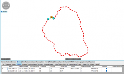

In Developer routing you should consider the following 2 step approach:
  • Determine the desired geometry by using profile #1 in a first routing request. Retrieve the route's ROUTE_ID.
  • Then perform a 2nd routing no longer based on thw waypoints but on the ROUTE_ID and apply profile #2
This approach also often helps to identify underlying restrictions if you wonder why a routing does not take the expected geometry. In this case you can
  • Perform a hardly restricted 1st routing and retrieve the ROUTE_ID
  • Apply the ROUTE_ID with the "real" profile and request ResultLists.VIOLATION_EVENTs to get a list of conflicts that the real profile vehicle would face when driving on the "expected" route #1.
Long route: triggers &quot;questions&quot;<br />Short routes: built based on &quot;lightweight profile&quot; and &quot;routeID&quot;
Long route: triggers "questions"
Short routes: built based on "lightweight profile" and "routeID"
