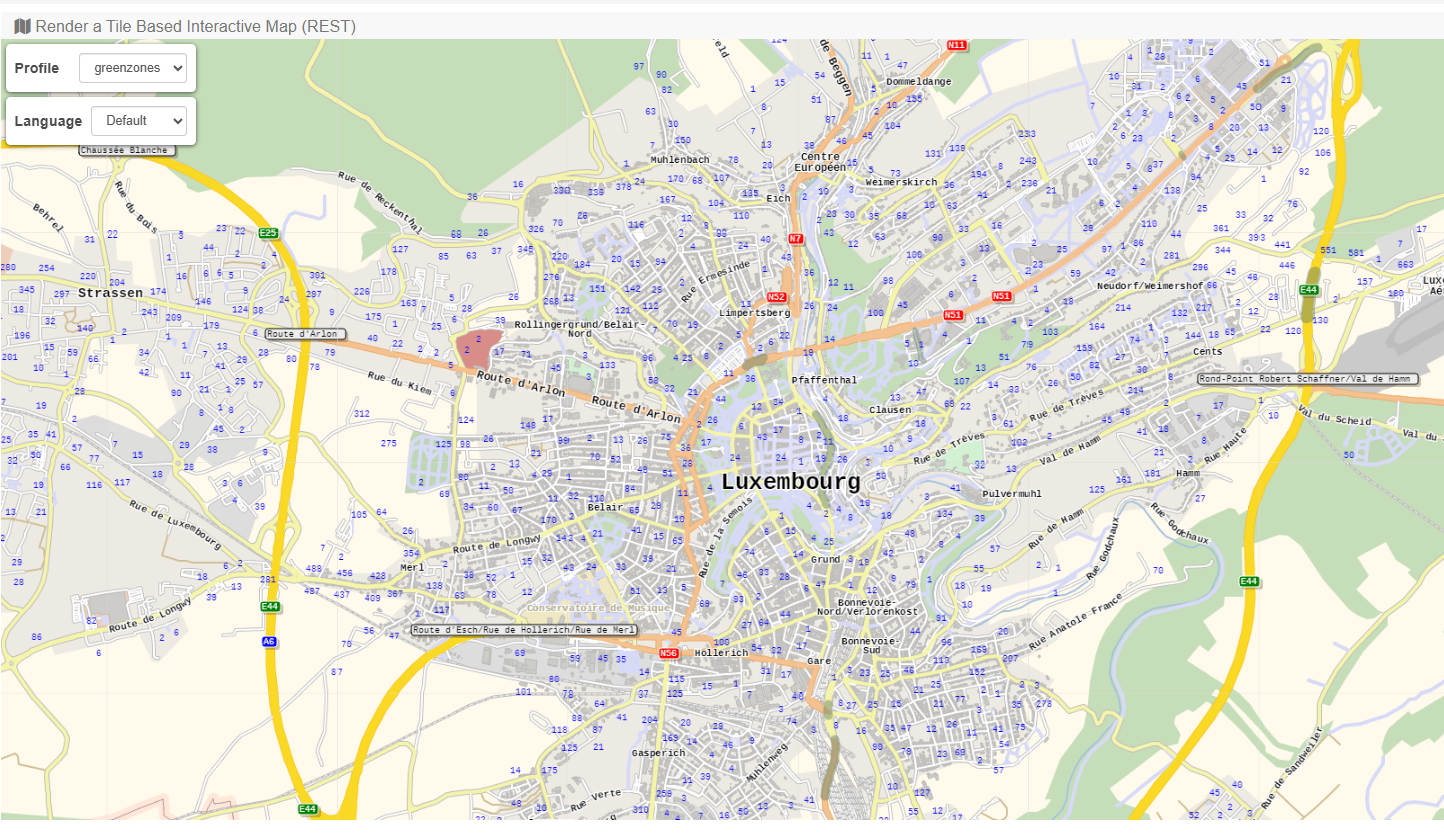

Here's what this looks like:
sample with a scale value of 3.25. Pretty ugly, isn't i?
