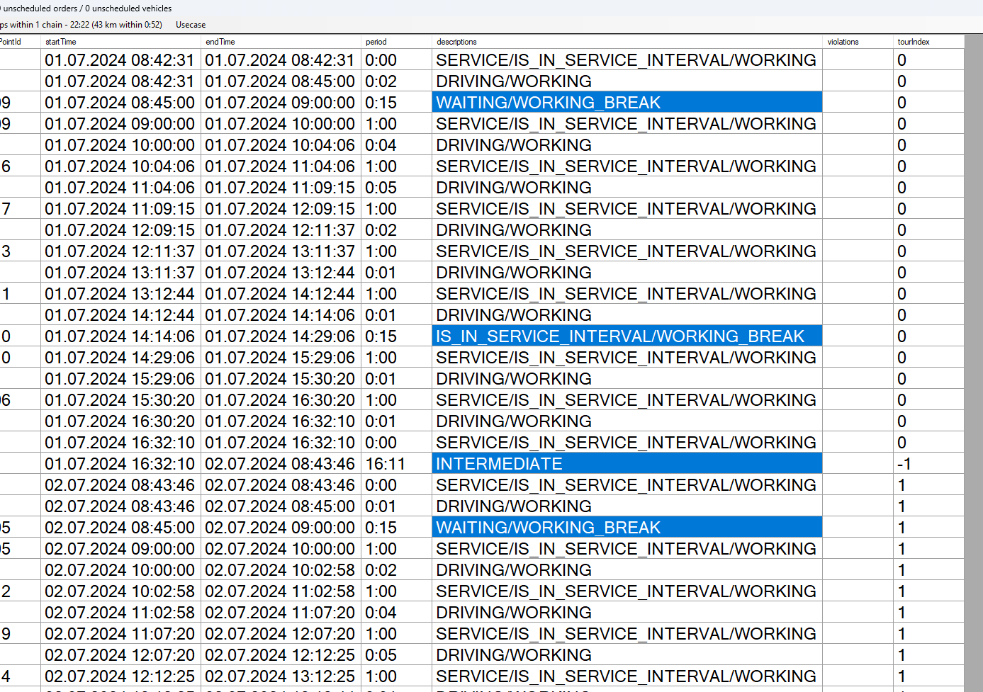

BREAK of 30 minutes: 14:00 - 14:30

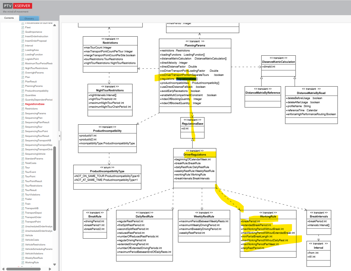

  • xTour1: Please check the com.ptvag.xserver.xtour.WorkingRule.

xTour1 WorkingRule
xTour1 WorkingRule

Example built with Developer Route Optimization OPTIFLOW: input vehicle definition
Example built with Developer Route Optimization OPTIFLOW: Result
