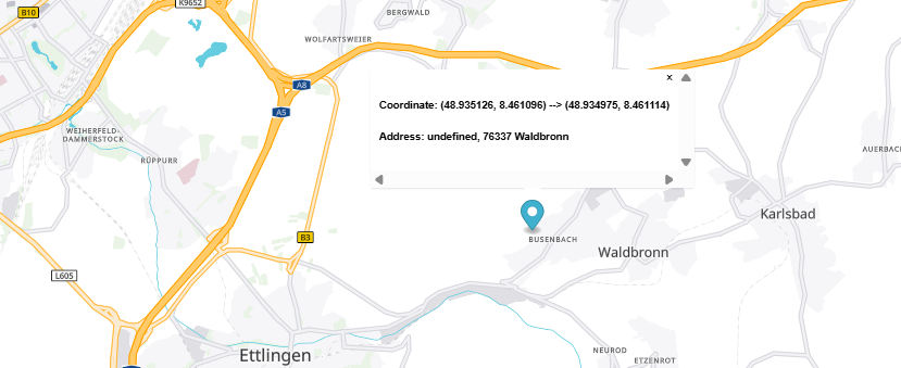

Hi Marko,
the answer to your question depends on the chosen mapping framework.
In the Developer tutorials we use the MapLibre library (a community driven fork of MapBox GL)
I just checked the Tutorials: position matching looks promising.
function addMarker(lngLat, textAsHtml) {
const popup = new maplibregl.Popup({closeButton: false})
.setHTML(textAsHtml);
const marker = new maplibregl.Marker()
.setLngLat(lngLat)
.setPopup(popup)
.addTo(map);
mapMarker = marker;
marker.togglePopup();
function clearMarker() {
if (mapMarker) mapMarker.remove();
mapMarker = undefined;
}Bernd Welter
