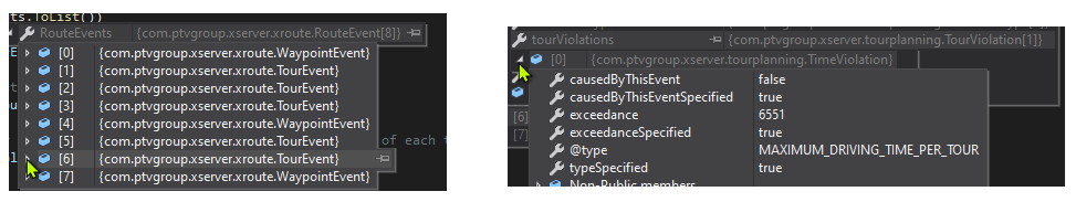

I am testing the xRoute/calculateRoute service with TourRestrictions, where I have set the ConfigurableWorkingHoursPreset to EU_DRIVING_TIME_REGULATION_FOR_SINGLE_DAY.
However, in the response, my calculated tour is 12 hours long, which exceeds the maximum daily driving time allowed by the regulation.
I noticed that in the Events list of the RouteResponse, this violation is detected, as I receive the MAXIMUM_DRIVING_TIME_PER_TOUR violation (see attached image).

As far as I know it is not possible to configure the request in a way that it generates a tour that does not exceed the regulation.
Keep in mind that xRoute.calculateRoute just connects the waypoints in the sequence as they are provided in the request. There is no optimization of the sequence included, even when specifying tour restrictions and also no modification of the waypoints is done. (ETA calculation is somewhat of an exception, of course).
What would be the expected result? Would you want a route that ends at the last waypoint before the exceedance occurs? Or would you want a route that skips as many waypoints as necessary to return to the first waypoint (assuming this is the depot) without exceeding the regulation?Is there a way to configure the RouteRequest to prevent generating a tour that exceeds this regulation,
I'd say so, yes. A violated result could also be a trigger to modify the tour and then calculate it again.From what I understand, the current approach seems to be that the service always generates a tour, regardless of violations, and it is then up to me to decide whether to accept or discard the result based on the reported violations. Is this correct?
I have a different understanding of the property. Route violations mean a violation of constraints of the roads, e.g. it was not possible to find a valid route for the given vehicle without violating the maximum weight restriction of a bridge. Or as another example the destination is linked to a road that is forbidden for trucks, hence it would not be allowed to drive there with your configured vehicle. If you set this property to true, then also such violated routes will be considered in the planning and might end up in the final tours.I know that in xTour, there is an ignoreRouteViolations property that controls this behavior, but I haven’t found an equivalent setting for xRoute when using a preset.

Re: Preventing Route Violations with ConfigurableWorkingHoursPreset
Hi Max,
Thank you for your prompt response.
We were expecting the route calculation to fail in the event of a tour violation and provide an explanation—or allow us to tweak the behavior through parameters. However, your approach works for us, since it lets us decide whether to proceed with the violated tour.
Please consider this issue resolved.
